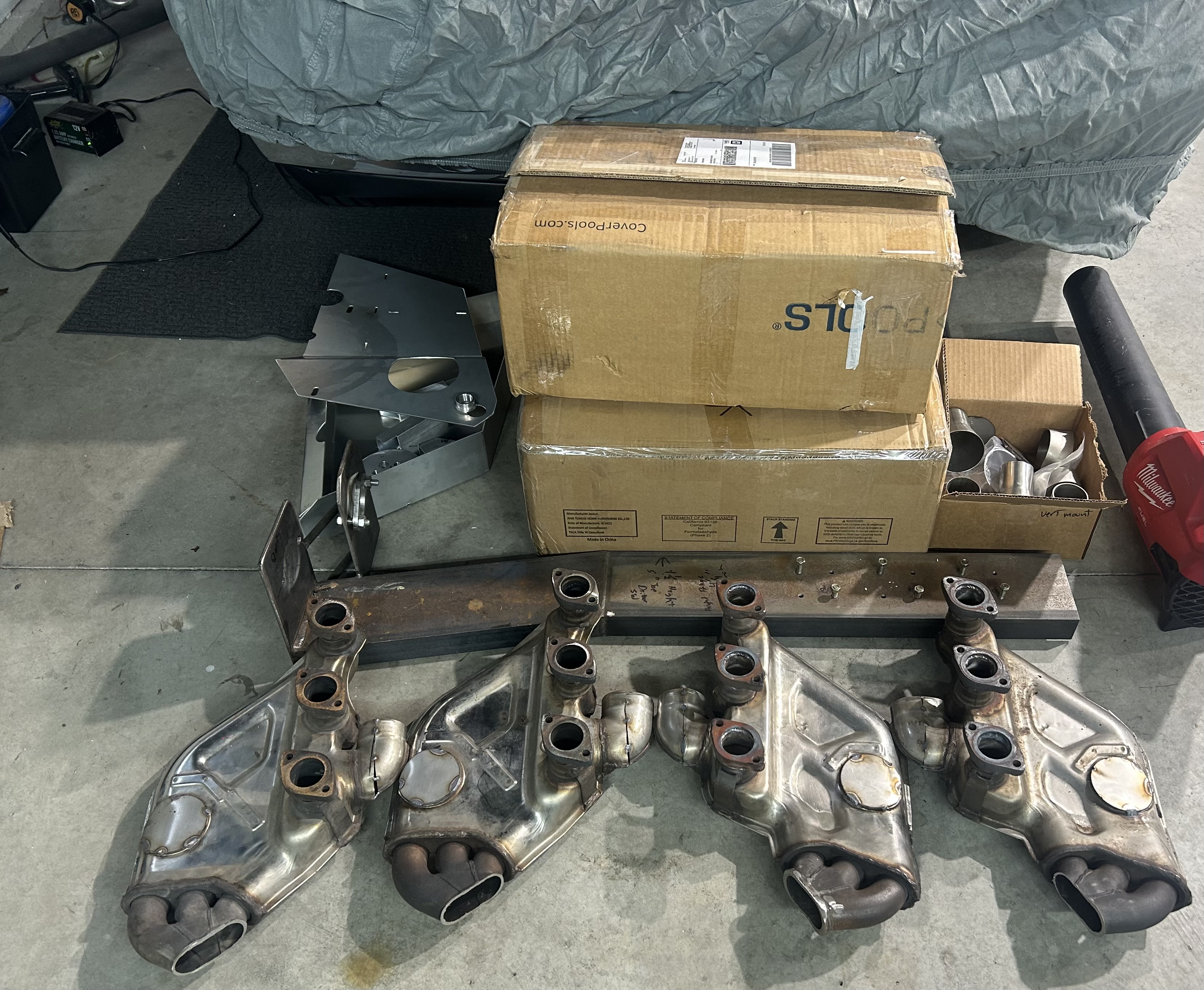

I have been dragging my feet doing these but got a good start this morning. This is a hard process to quote that’s for sure as it is straight up custom. I run this set up on my hot 2.4 with 1.5” sleeves and they work really well. A good solution all the way up to 3.6Attached Image

The biggest issue so far is finding reasonable cores. The ones sent to me by clients so far have cost them about $500 and then they are into me for about $1500 (supply chain issues changing pricing which equals more time on the next sets I do) your in $2000 pretty easily

mb911   Bischoff are easier to convert. I am in process of...   Dec 21 2024, 03:30 PM

mb911   Second batch   Dec 27 2024, 08:22 AM
mb911   Another 2 sets and a GT bumper   Jan 21 2025, 10:58 AM
