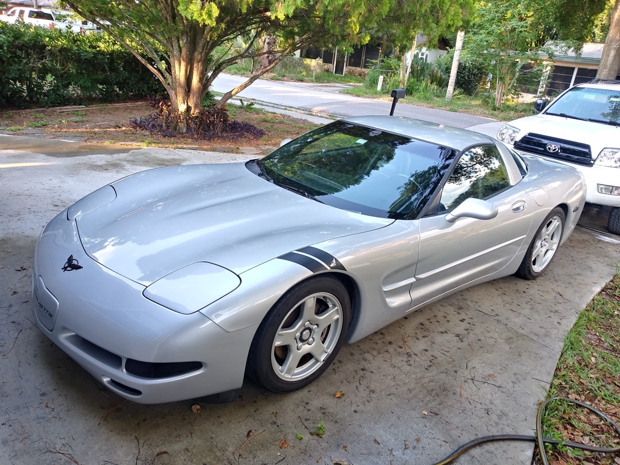

I bought the Corvette from a man down in Miami who had it stolen from his driveway and purchased a new one with the insurance money. They found it 3 months later in a shipping container bound for overseas. I picked it up for 7k and dropped 7k in the engine and suspension. It’s a Super fun car to drive….endless burnouts for days and Sooo much fun to power slide through long corners…lol.
