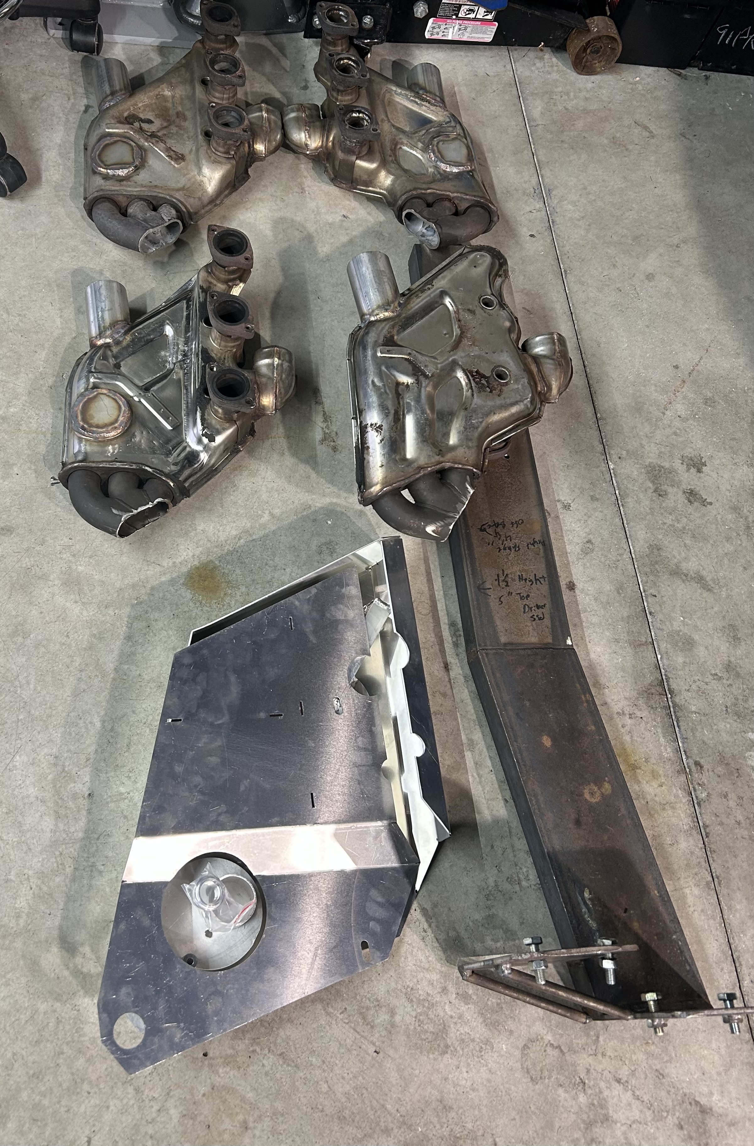

I have been dragging my feet doing these but got a good start this morning. This is a hard process to quote that’s for sure as it is straight up custom. I run this set up on my hot 2.4 with 1.5” sleeves and they work really well. A good solution all the way up to 3.6Attached Image

Second batchAttached Image

Steve   Awesome that you are doing this, but is it less wo...   Nov 27 2024, 08:48 AM
mb911   Awesome that you are doing this, but is it less w...   Nov 27 2024, 09:02 AM
tygaboy   I'll be helping @napasteve Steve with his 3....   Nov 27 2024, 09:25 AM
mb911   I'll be helping [b]@[url=http://www.914world...   Nov 27 2024, 09:28 AM
mepstein   “This is a hard process to quote that’s for su...   Nov 27 2024, 09:34 AM
mb911   “This is a hard process to quote that’s for s...   Nov 27 2024, 10:03 AM
worn   “This is a hard process to quote that’s for ...   Nov 27 2024, 04:47 PM
mb911   [quote name='mb911' post='3179134' date='Nov 27 2...   Nov 27 2024, 05:49 PM
