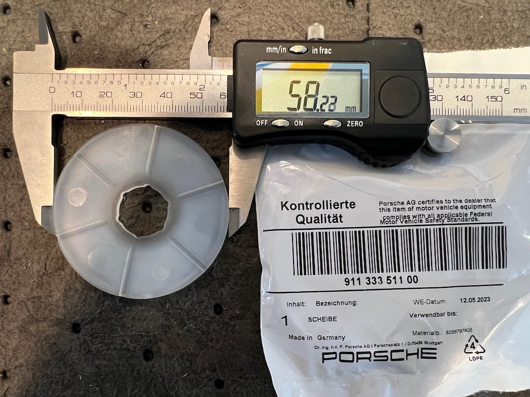

An update regarding #5 from parts catalog diagram 901-333-511-00 Stop washer for rear shocks. Non-metal rubber or plastic type of material. OD: ~ 54 mm.
While the original part is NLA, there is a shipping part (as of 2024) that appears to be similar material and has the grooves that Jeff suggests act as a vent to keep the stopper from acting as a vacuum pump and sucking fluid past the shaft seal.
It is 911-333-511-00. Slightly larger at 58mm.
