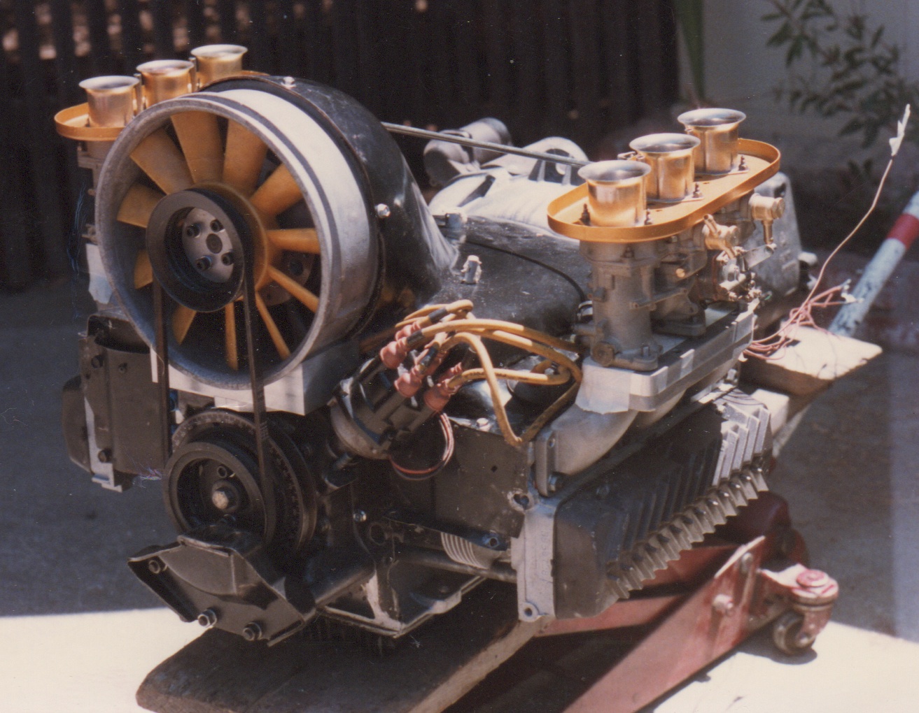

Has anyone here built a 914 Type 4 using the LN Engineering 2563-190 kit?

Believe it fits..
Kennedy did make an adapter …. Corvair runs backwards… reverse cam available or
flip the R+P.??
Plenty of parts available and cheap compared to Porsche..
High Rev..??? Not stock..
All sorts of options including big bore 3.0..and stroked to 3.3 for bigger money. They use those in airplanes..
Then there is this ….????!!!!
