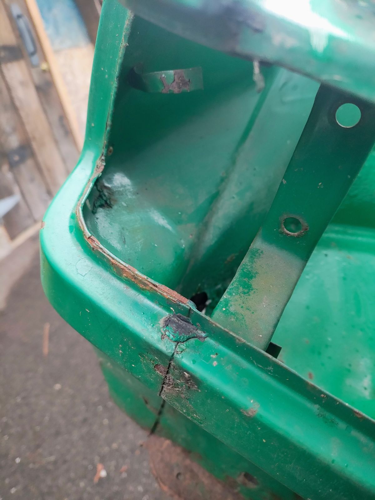

Replacing rear quarters, rear panel (previously brazed) and looking for the simple way to separate the quarter from the rear panel. It appears smallish spot welds, but ....
Wondering to slice the perimeter and fill the gaps when welding back together.
Probably no simple solution, but
TIA

Nice detail, outer quarter panel wraps around the inner fenderwell
not so easy to seperate, the Blair cutter is a bit large for this.
Thanking I might cut the perimeter with a thin wheel and butt weld it back when all is assembled
