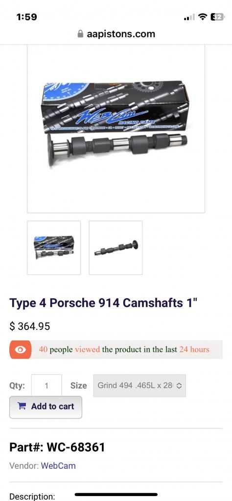

Web Cam has a 494 grind with a 1” base circle meant for 80mm+ cranks. BTW, I measured a 1.044 base circle with my digital caliper on my cam. So probably it’s 1” since I was just measuring 90 degrees from the lobe.

technicalninja   Looked at that cam. That wouldn't be my first ...   Jan 1 2025, 02:47 PM

technicalninja   https://aapistons.com/collections/porsche-p...ston...   Jan 3 2025, 11:45 AM
friethmiller   https://aapistons.com/collections/porsche-p...sto...   Jan 3 2025, 12:05 PM
