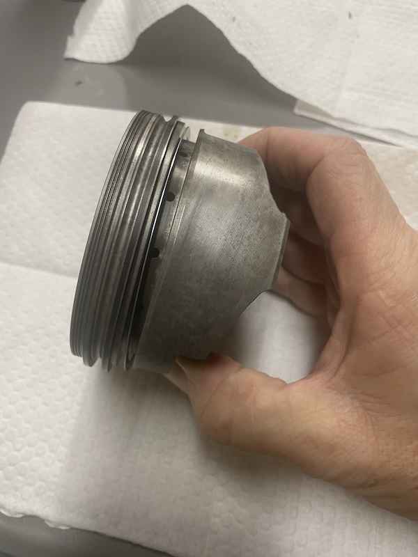

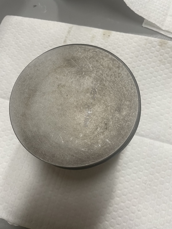

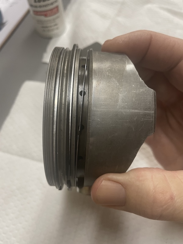

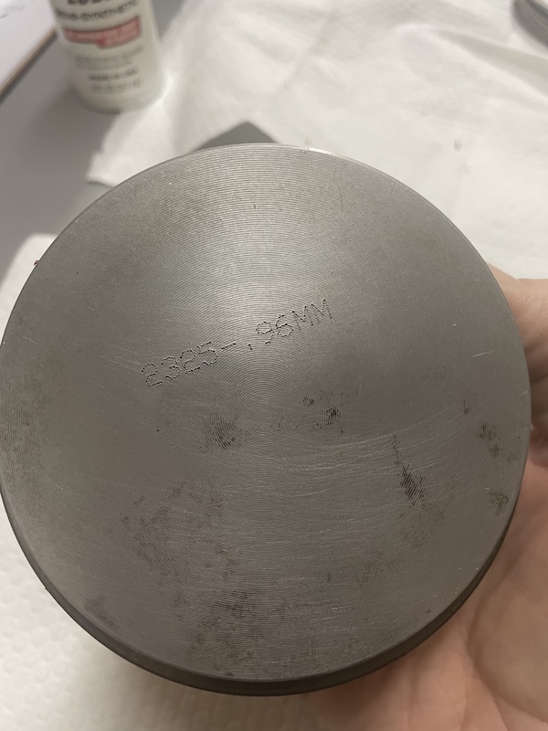

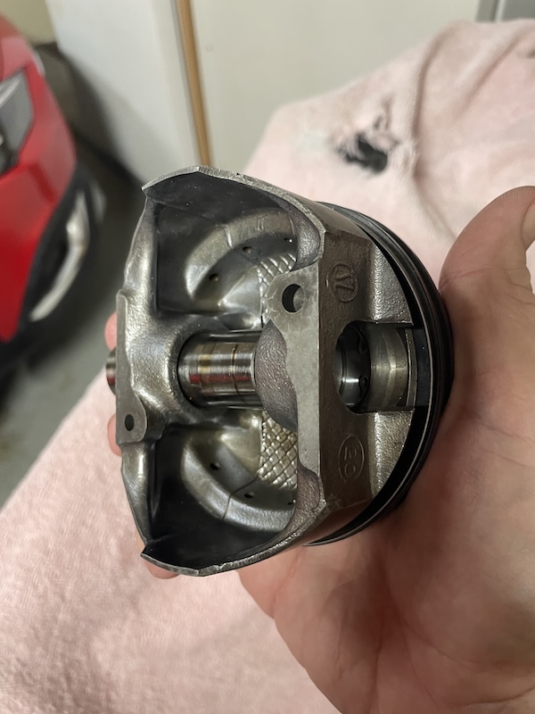

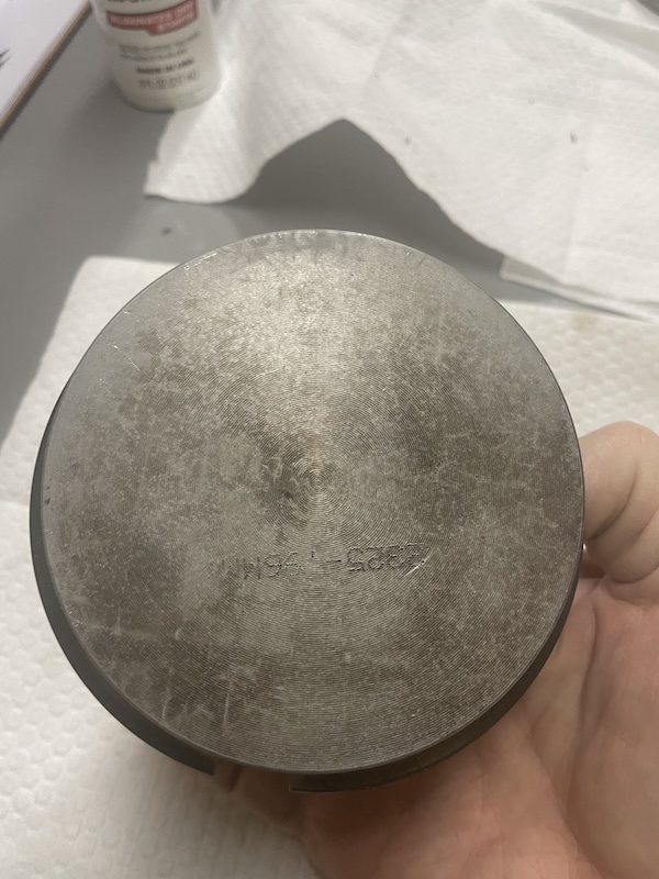

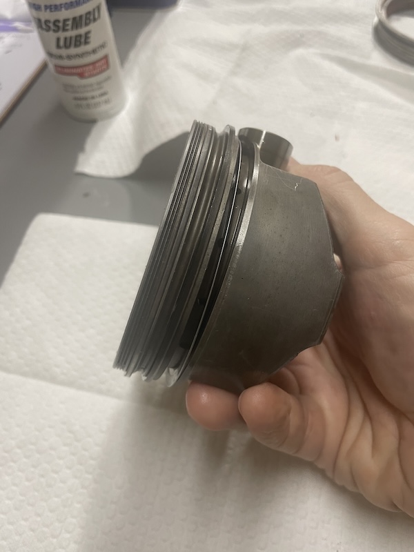

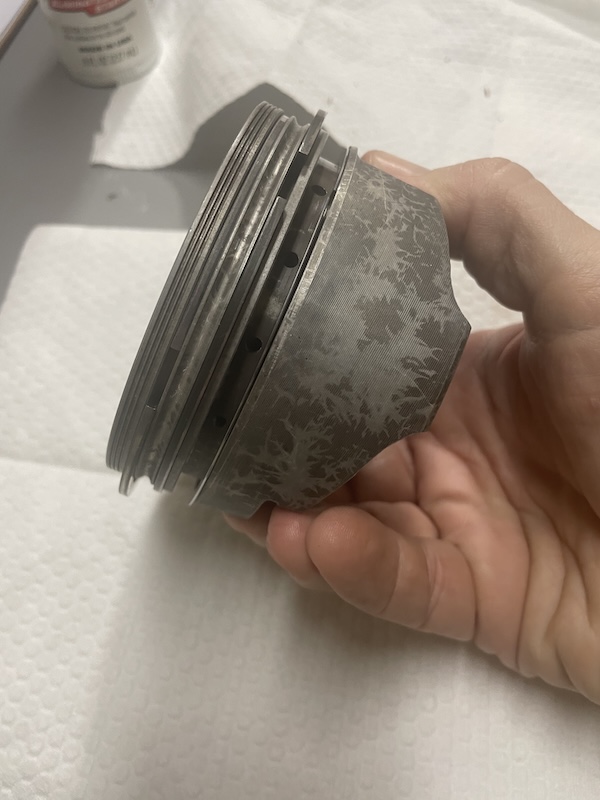

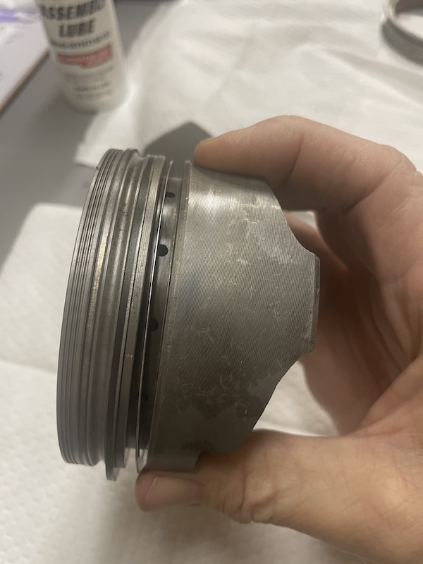

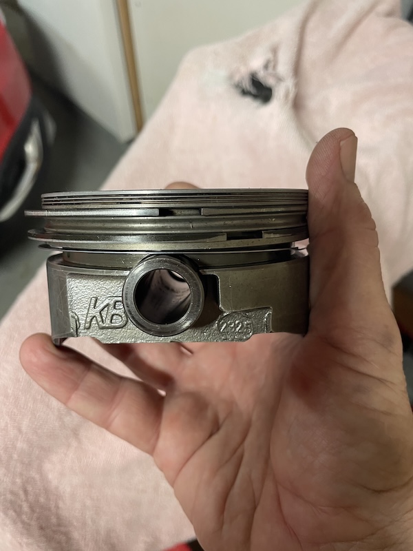

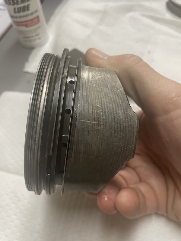

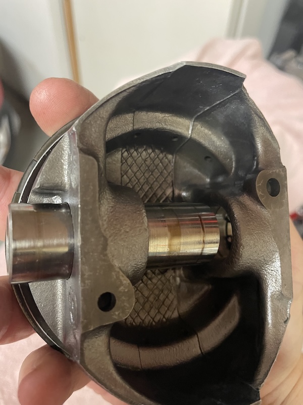

Rick, in the interest of time and money, I'm going to stick with my dual 44 IDFs and my 1-5/8" Tangerine Exhaust. I'm thinking that should be sufficient to feed/exhaust this engine. Here's some pics of the pistons. Definitely JE Forged pistons with 22mm wrist pins.
Here's some pics:
Note: the weird spider look on some of the piston came from the ultrasonic cleaner.

technicalninja   Those might not be JE pistons! I have 2 new s...   Jan 1 2025, 02:24 PM

technicalninja   Those ARE Keith Black "silverlines". Tha...   Jan 1 2025, 04:03 PM
friethmiller   Those ARE Keith Black "silverlines". Th...   Jan 1 2025, 05:56 PM
technicalninja   I noticed it almost looks like those have a solid ...   Jan 1 2025, 04:14 PM
