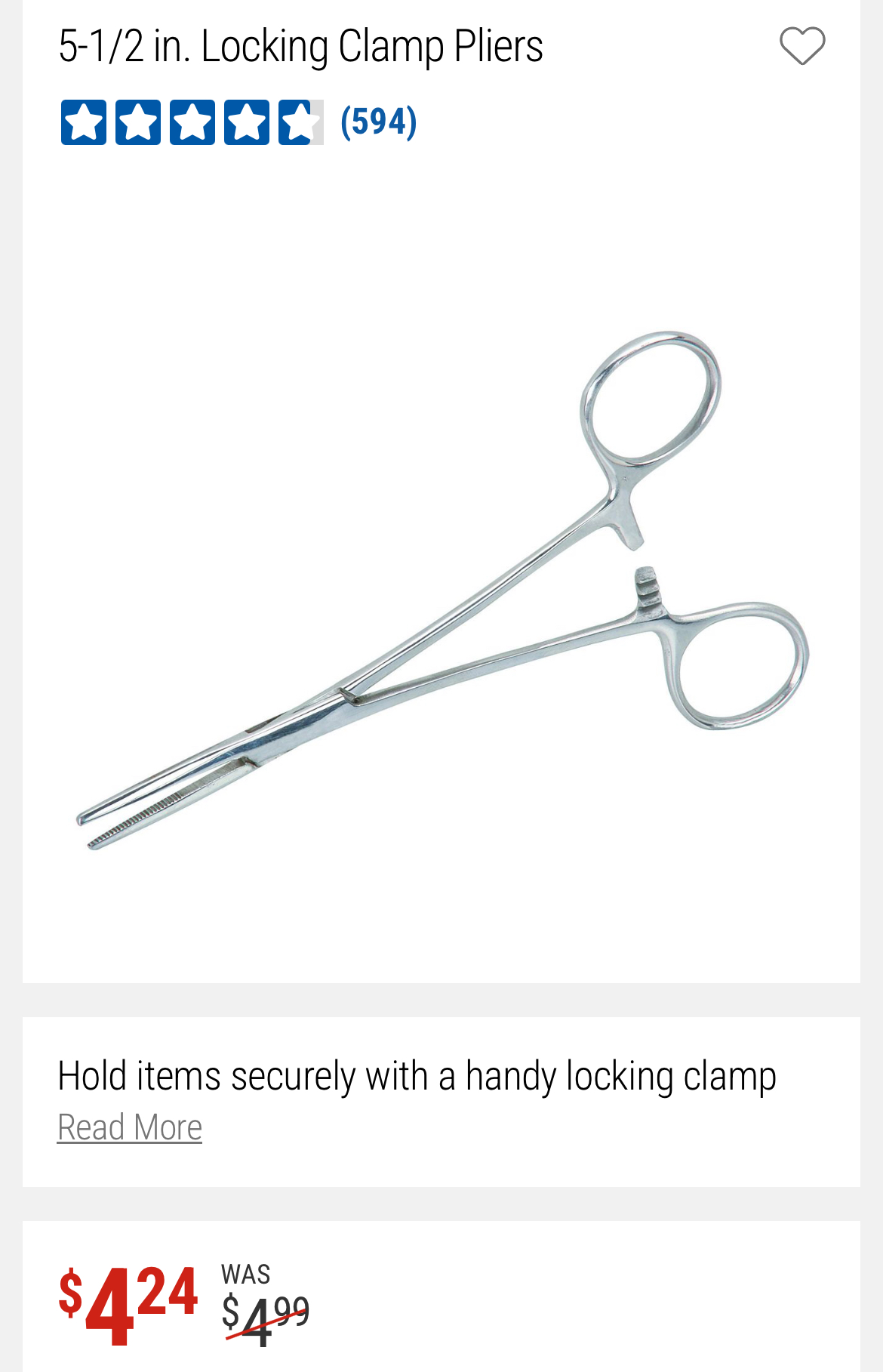

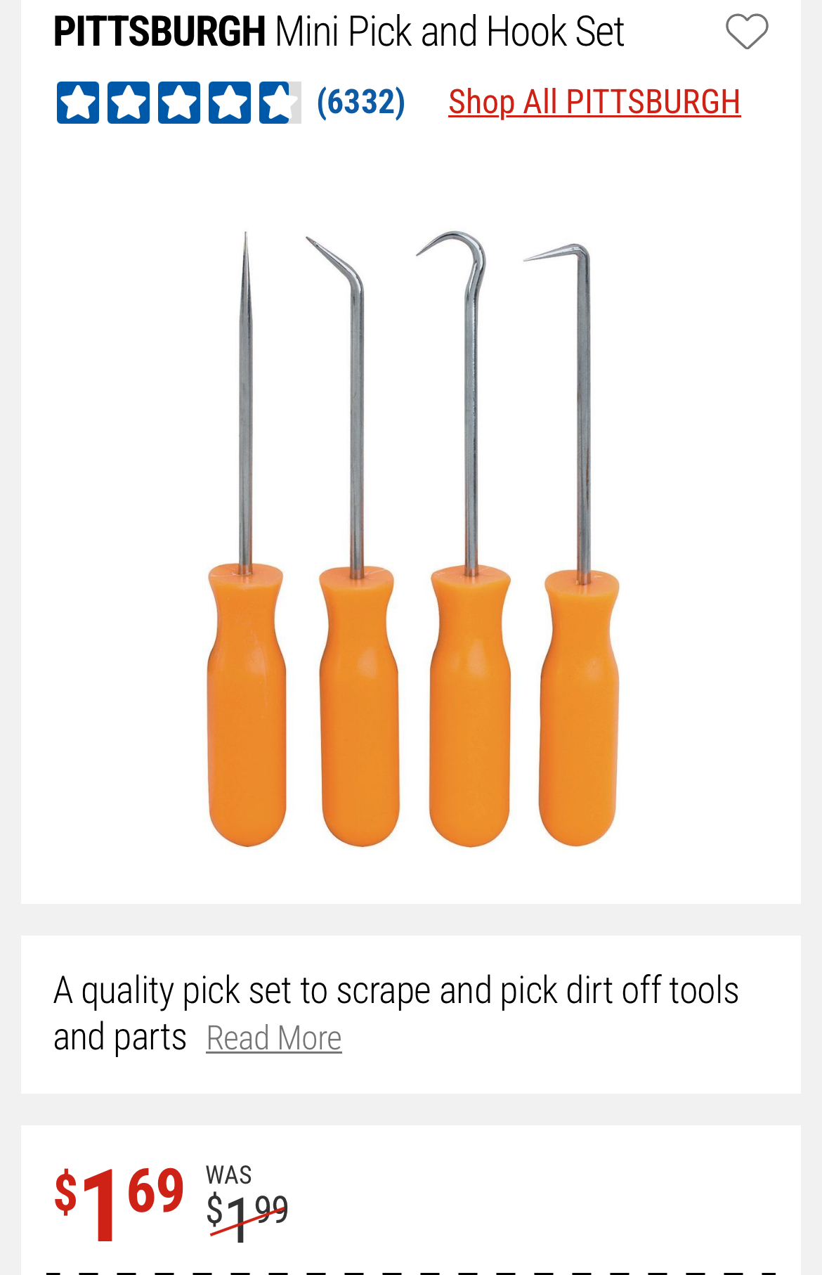

QUOTE(Superhawk996 @ Jan 1 2025, 04:28 PM) *
I had already tried the mini pick and hook set, to no avail. I'll try the locking forceps; I know I've got a pair in the toolbox from the old college days...

drmitch   Pray tell, how does one remove the old crush sleev...   Jan 1 2025, 05:27 PM
RAX914   Pray tell, how does one remove the old crush slee...   Jan 1 2025, 06:50 PM

drmitch   I had already tried the mini pick and hook ...   Jan 1 2025, 07:34 PM
Superhawk996   I had already tried the mini pick and hook set, ...   Jan 1 2025, 09:37 PM
drmitch   I had already tried the mini pick and hook set,...   Jan 2 2025, 05:59 PM
Superhawk996   [quote name='Superhawk996' post='3184444' date='J...   Jan 2 2025, 07:41 PM
