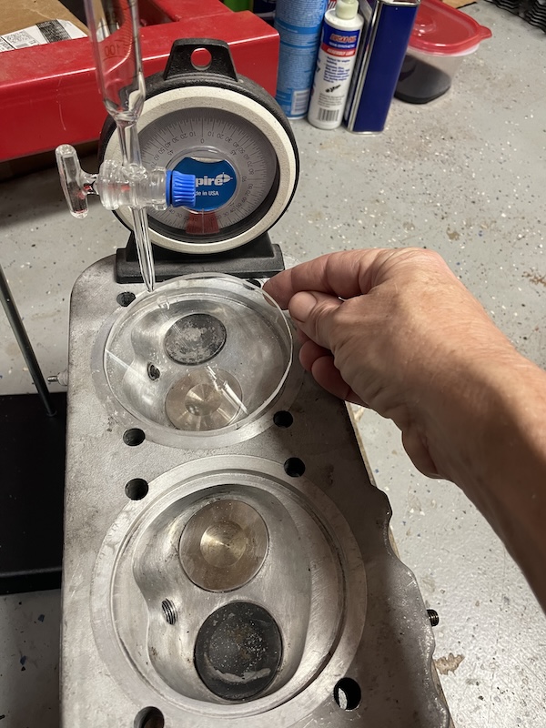

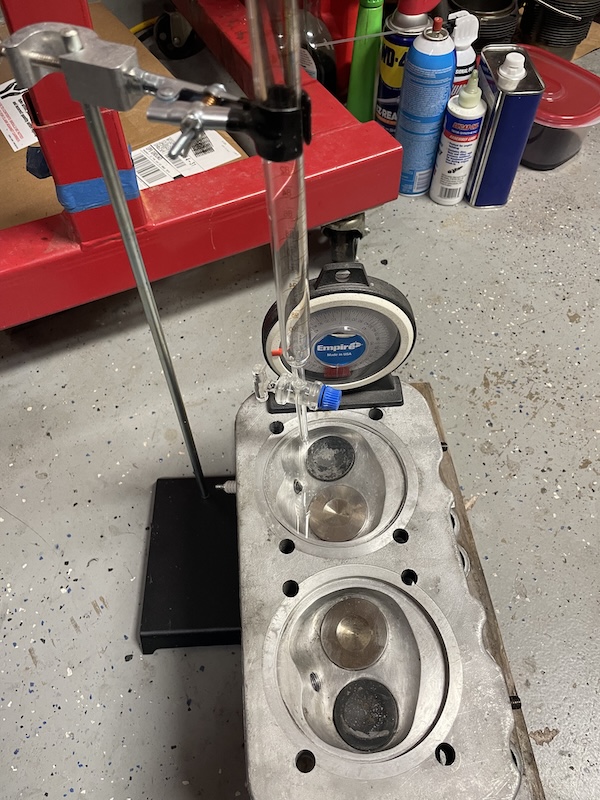

Going to cc the heads first. I measured the ID of the cylinder register in the head and drew a 105mm circle on the square plexiglass. Cut it out with a jigsaw and sanded down the edges to get it to fit. Hopefully this will work! Instructions say to lightly grease the plexi where it interfaces with the head to create a seal. Plan to attempt this this evening. Here's some pics of the setup on the garage floor. Going to move this to a work bench and level the head before testing.

technicalninja   The above looks good. Easier to see the bubbles i...   Jan 2 2025, 09:23 AM
technicalninja   These might help. https://www.amazon.com/ABN-Cyli...   Jan 2 2025, 09:26 AM
