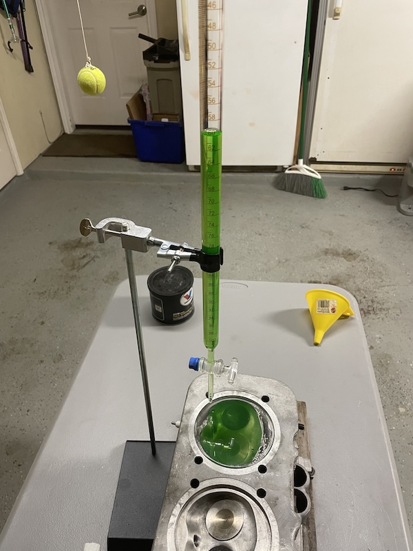

Ok, Cylinder test via antifreeze titration says 60cc. I'll get the engine/parts put together to test the cylinder stroke this evening.

friethmiller   Going to cc the heads first. I measured the ID of...   Jan 2 2025, 08:56 AM
technicalninja   The above looks good. Easier to see the bubbles i...   Jan 2 2025, 09:23 AM
