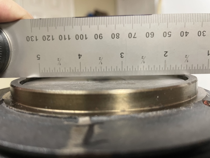

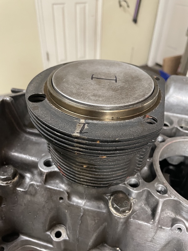

@technicalninja - Initial look at deck height here.
#1 Cylinder at TDC without any shims:
#1 Cylinder at TDC with the two shim stack (installed by FAT). This gap is north of .085.
