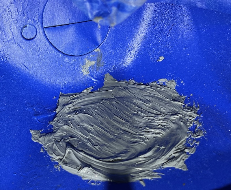

Here is what the Wurth Brushable Seam Sealer looks like when applied. It has a super thick consistency. Doesn't even need to be stirred. Was pretty easy to work down into the crevice using a brush.

mepstein Seam sealer. Used all over the car. Lots of modern... Oct 22 2024, 07:51 PM

There is a brushable version too. Both sprayed ... Oct 22 2024, 07:55 PM

Zeke There is a good polyurethane strictly for the seam... Oct 22 2024, 10:57 PM
mepstein It is flexible but so is paint. Think about how al... Oct 23 2024, 01:57 PM
Superhawk996 Factory painted over it. Designed to be painted o... Oct 23 2024, 05:57 PM
nivekdodge it says for primed and unprimed but i would surely... Oct 23 2024, 06:10 PM
930cabman NAPA has a decent "brushable" product. A... Jan 3 2025, 12:56 PM
technicalninja
Factory painted over it. Designed to be painted ... Jan 3 2025, 12:59 PM
Superhawk996
Now, seam sealing a temporary job that you INTEN... Jan 3 2025, 04:51 PM![]() ![]() |
