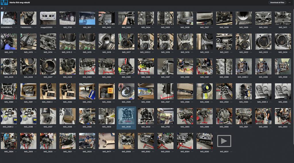

@ friethmiller
I just spent a bit of time with Mark Sonners going over the build that we did on his 2270 built by Jake Raby, over 20 years ago. We have a lot of pictures that I took during the disassembly and the reassembly and the parts. Mark is going to put them up online here in a way that people would be able to easily get to them. There's a lot of pictures.
This Eng has RAT case, RAT HAM heads and I think you are overthinking it. If you do what we did on Marks Eng. And put in the oil cooling up front I think you will end up with a very nice build and no overheating.
Best Bob B
(IMG:style_emoticons/default/driving-girl.gif) (IMG:style_emoticons/default/driving-girl.gif) (IMG:style_emoticons/default/driving-girl.gif) (IMG:style_emoticons/default/driving-girl.gif) (IMG:style_emoticons/default/driving-girl.gif)
Also, note the windage tray that Jake did. It has been modified
The folder will have 83 Pictures and the start up Vid.
Marks Server https://artbox.industryartworks.com/s/of8CKoNyptHf6X7?
