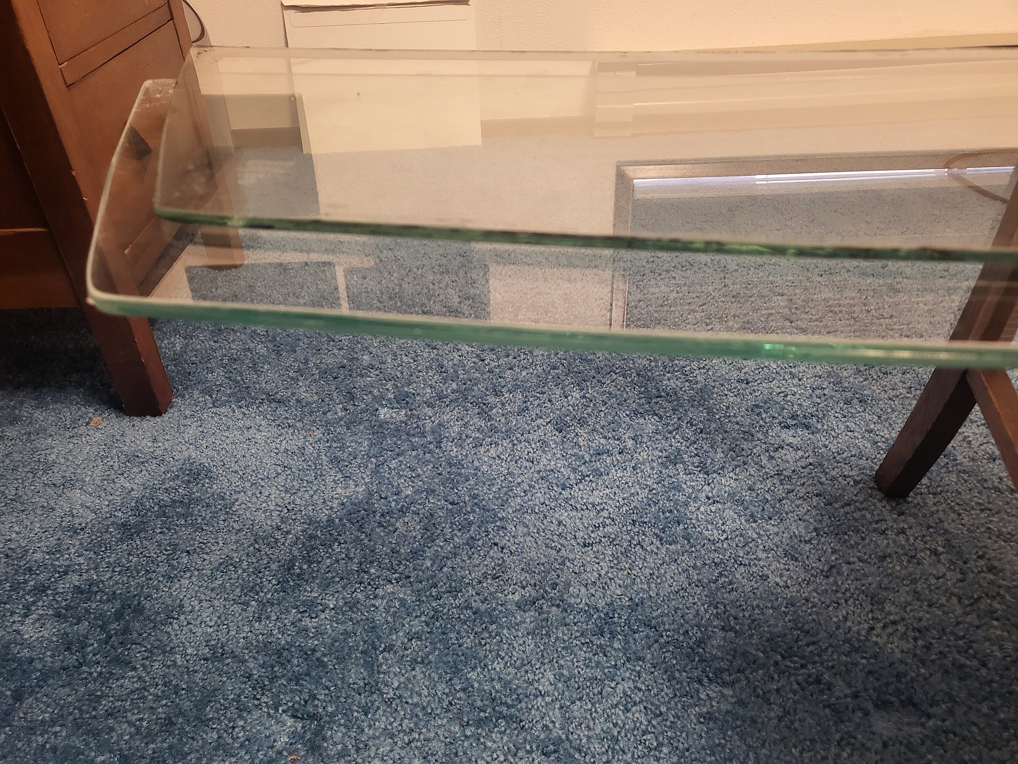

Picked up the new window yesterday. Shop did a really nice job with the edges. It's roughly 50thou or 3/64" thicker than the stock window. Glass was only about $100 and it was $125 to cut.
I won't be able to put everything back together until early February. Dropped the backpad off to get re-glued and that will take the longest. Upholstery shop is just that busy.
New seal should be here from 914Rubber pretty soon so at least I'll be able to post how the slightly thicker glass fits against the three targa pieces.
Original on top, new laminated on bottom:
