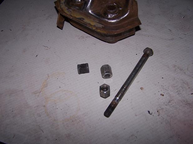

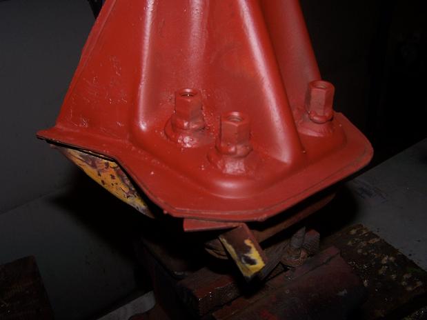

I had the same thing happen to every one of my studs. Didn't know that much about the way the bolts were held in and snapped every bolt.
I drilled out every bolt with a small drill, then larger and larger until I could slide a bolt all the way through.
Temporarily I put a bolt through with a nut and washers through all
Then added my own nuts welding 2 in series then welding to the mount.
