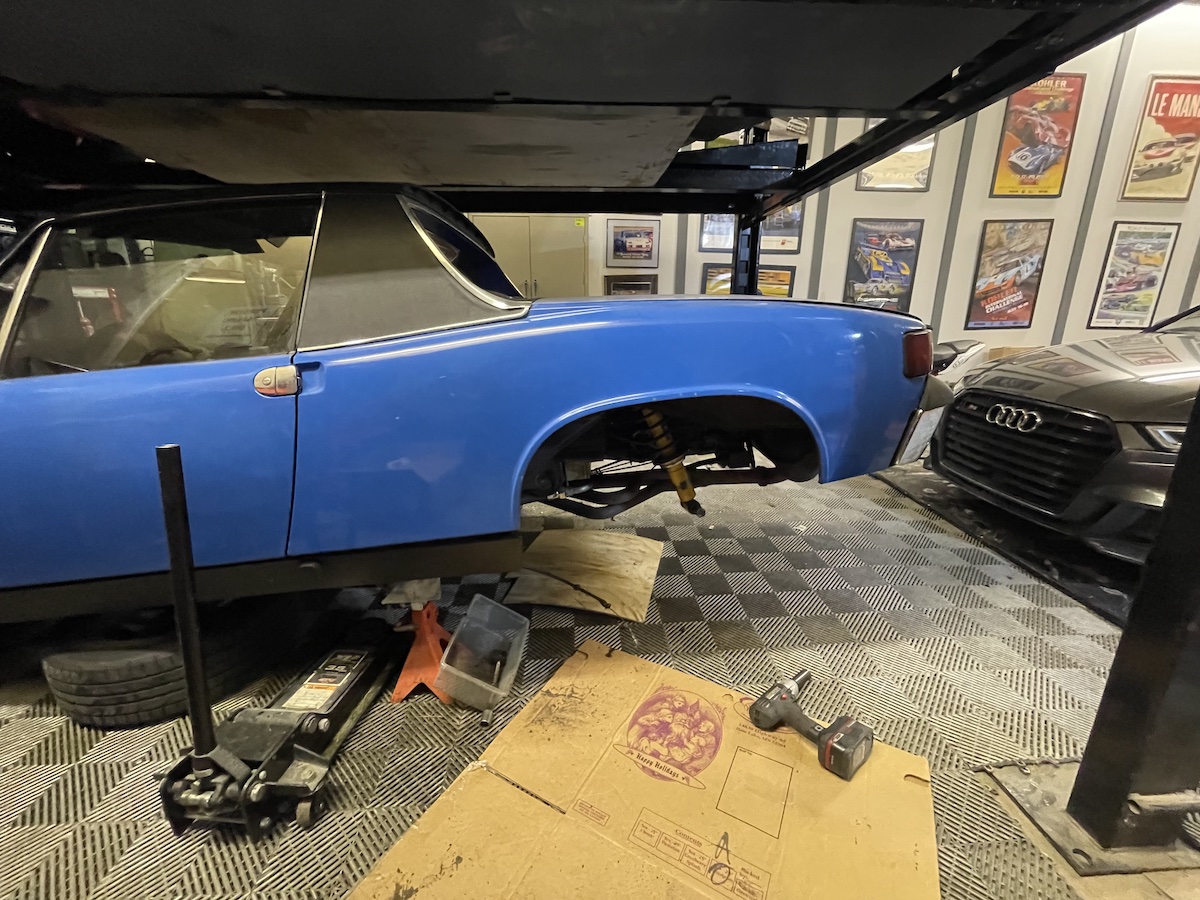

The rear shocks are reaching the end of their life, so I ordered up a set of replacements. Preparing to get them installed I got a case of while-you're-in-there and decided it was a good time to replace the trailing arm bushings. I didn't see any record of them being replaced in my pretty extensive records for the car, so I figured there wasn't a better time than now.
So off came the trailing arms...

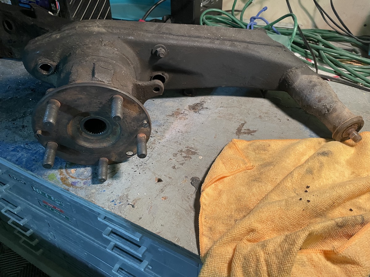

Once removed from the car I couldn't get over how dirty and nasty the trailing arms were. Now if you've followed this thread you may remember I replaced both rear wheel bearings lately, a task I now regret given I plan to blast and refinish the trailing arms.

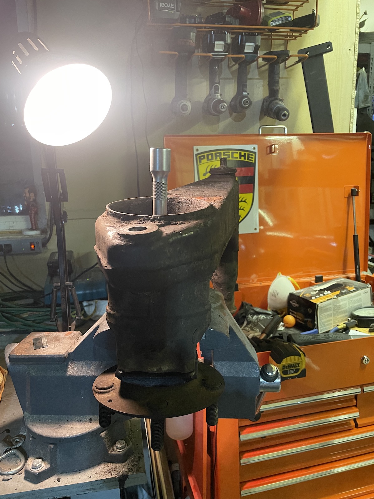

So out came the hubs...

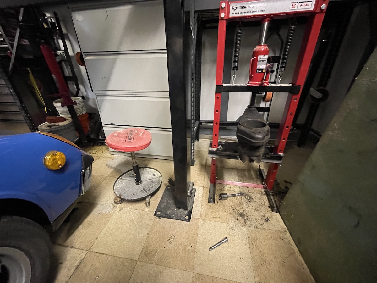

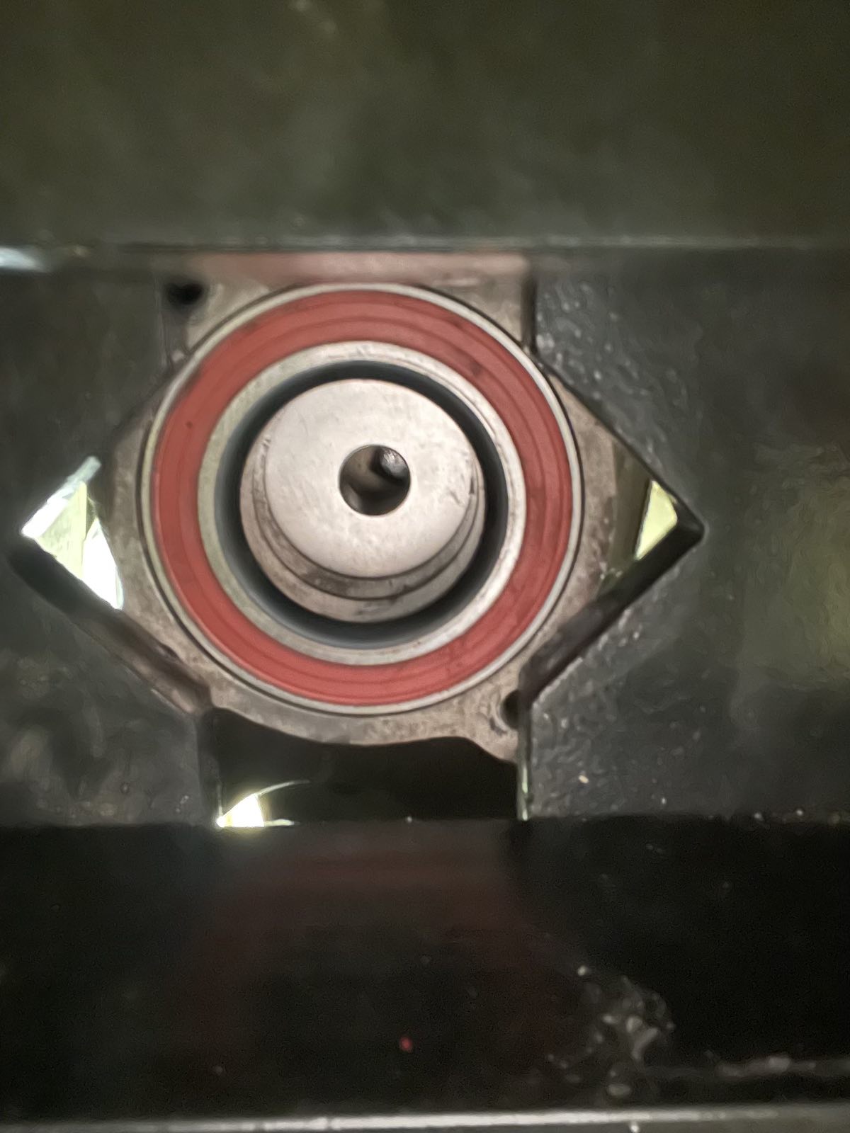

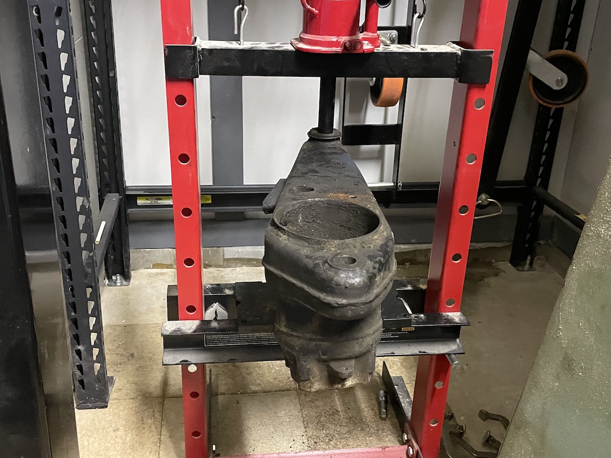

...and then the bearings. Fortunately I've essentially doubled the value in the Harbor Freight press I convinced myself I needed a few years ago for some other project.
Finally, I proceeded to remove the trailing arm shafts. I was whistling the whole time, knowing I had now tripled the value of my investment in my hydraulic press.
Now, over the years, I remember seeing many threads of people lamenting the removal of their old rubber factory bushings, involving blow torches, anxious anticipation of a puff of black smoke (as if they were awaiting the arrival of a new pope), and a bunch of jerking around. But as if the wrenching gods were looking down on me, I was spared. Or perhaps I just had the right tools for the job.

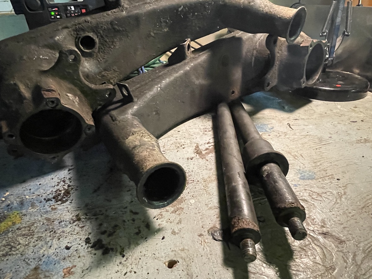

And with what only took a few minutes to recap in this thread, but in reality was a few nights of expletives and busted knuckles, I managed to have two hulks of greasy, grimy 914 trailing arms on my bench.
So now, two questions on how I proceed from here:
1) My trailing arm shafts are pretty corrodded, and its my intentinon to replace them. Should I replace them with PMB's fancy stainless shafts and stick to rubber bushings, or should I go the Elephant Racing Polybronze route? I have the latter on my track car and they're great, but I'm not sure I really need them on the street car.
2) The rear springs are a bit soft for my likings, and given I've never achieved a low BMI score, i'd like to up the spring rate. My leaning is towards threaded Ground Control collars (I have them on the other car) and either 150 or 175lb springs. All my forum research suggests I should err on the softer side.
