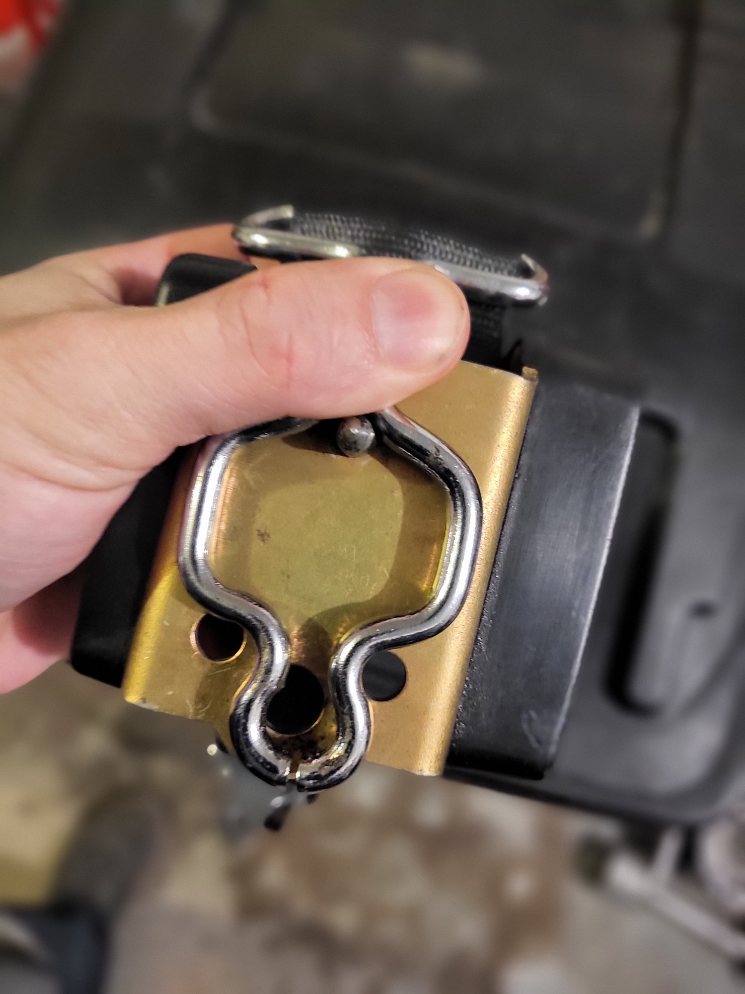

Got my belts back from Seatbelt Planet and installed them loose to see how they worked. The new webbing is top-notch, but I wish they would have cleaned and lubed the mechanism. I specifically asked that be done and I can tell it wasn't touched. Oh well, I still have to help the belt retract which sucks.
For the OP, here's what I believe to be the correct orientation of the guide bar: Attached thumbnail(s) |

windforfun The belt is flipped. The inside edge behind the b... Jan 8 2025, 07:09 PM

windforfun I think your belt is still flipped. Maybe mine is... Jan 11 2025, 08:23 PM
