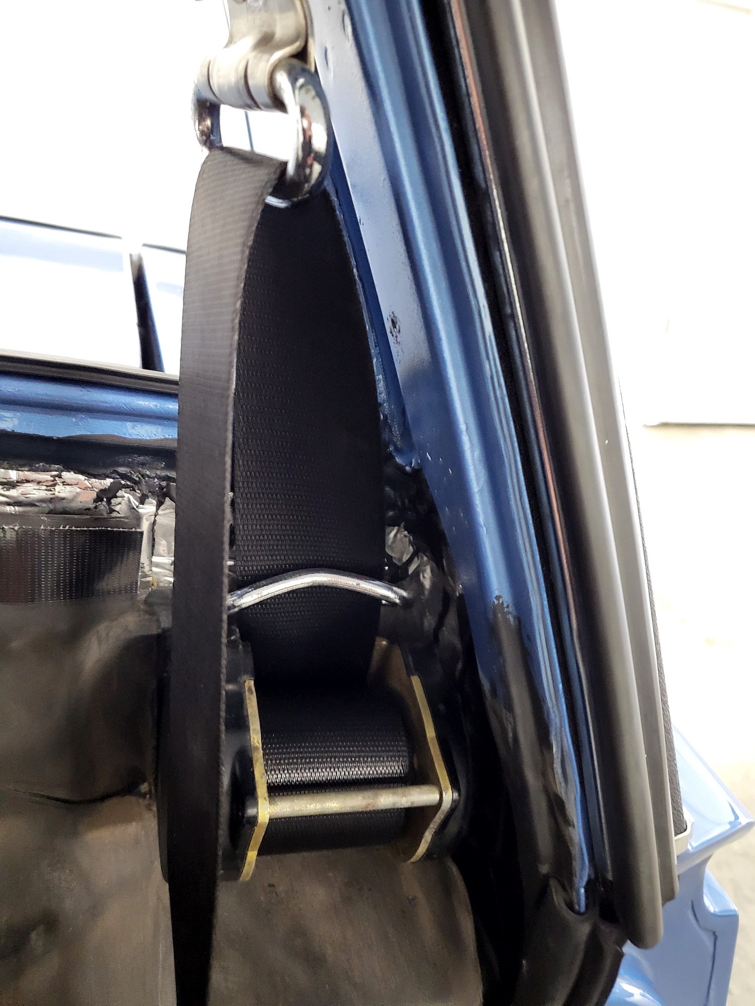

Here's a shot installed, just to see how things worked.
Anyone know any tricks to getting some lube on the spring side without taking the cover off? I've only taken the cover off a couple of times and spent the next 6 hours getting the spring back in. Would prefer NOT to have to do that again! (IMG:style_emoticons/default/dry.gif) Attached thumbnail(s) |
