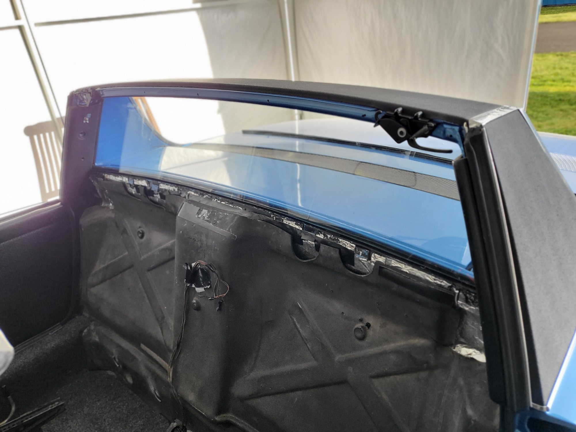

Installed the window today and put the two side pads on to keep pressure on the seal. It was 45 degrees out, so the butyl was very slow to compress. All in all, the window seemed to install pretty much the same as the factory. The 3/64" extra thickness didn't impact the installation. More the cooler temp did.
I'll let it sit like this for a few days, let the seal continue to compress a little. I'll be adding a 3rd brake light, that's why I didn't install the longer targa pad yet.
More to come.
