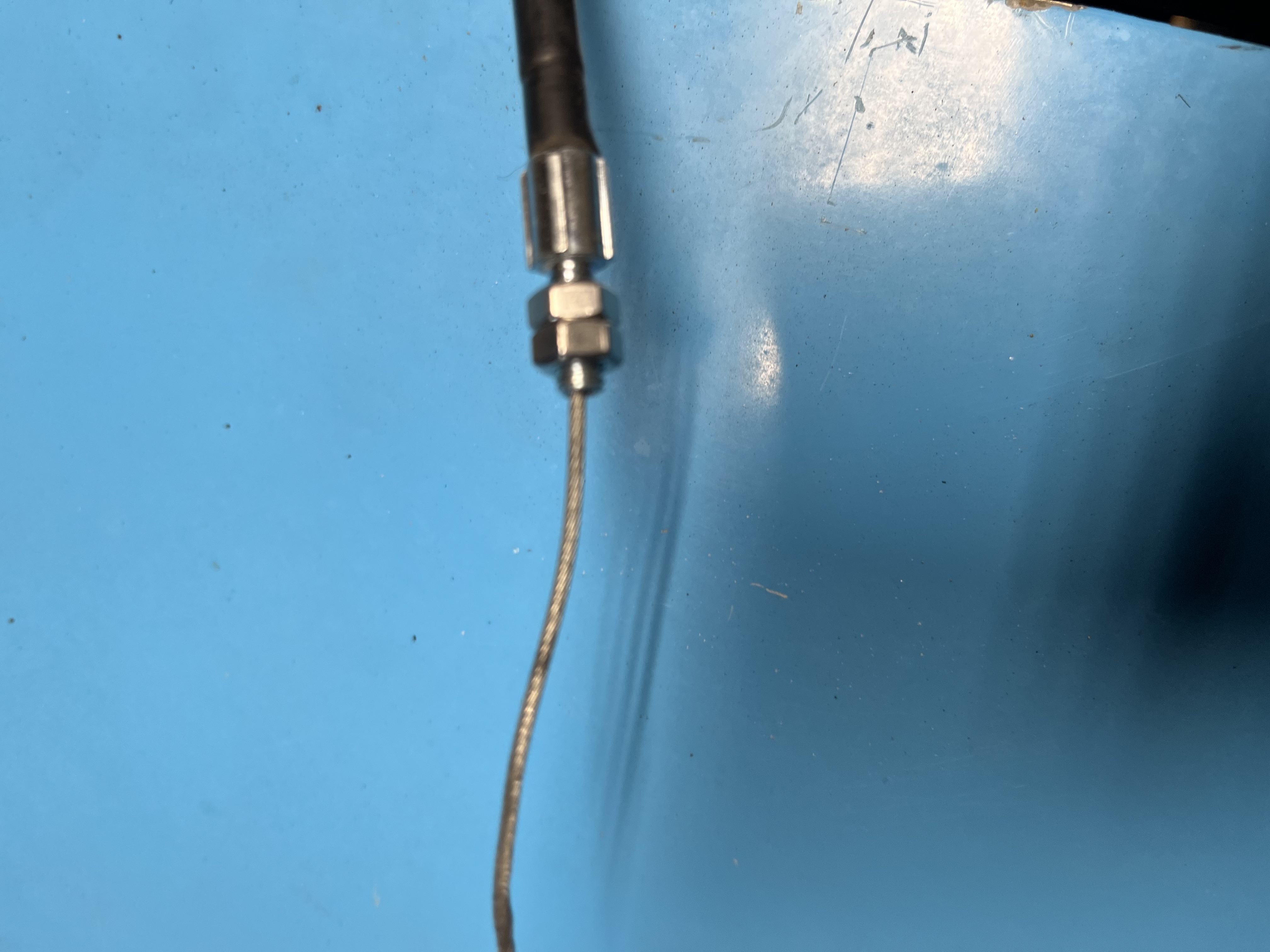

I would like some advice as to the best accelerator cable mount and location for a 74 type 4 i am working on. i've only owned fi so any help will help. Also is there a certain cable shroud part that holds the cable shroud to the mounting bar allowing little to no resistance for the cable to move freely. Thanks (IMG:style_emoticons/default/sawzall-smiley.gif)

i have to give it to the local bike shop....aprox 2mm cable and aprox 6mm od casing part that fits perfectly and a quick visit to ace hardeware for the nuts...Attached Image
