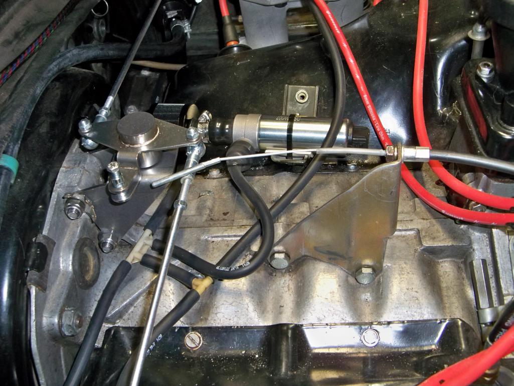

I would like some advice as to the best accelerator cable mount and location for a 74 type 4 i am working on. i've only owned fi so any help will help. Also is there a certain cable shroud part that holds the cable shroud to the mounting bar allowing little to no resistance for the cable to move freely. Thanks (IMG:style_emoticons/default/sawzall-smiley.gif)

QUOTE(randyt914 @ Jan 11 2025, 05:03 PM) *
i was wondering what the part looked like...and where is the best type 4 914 mounting area for that bracket.
The bracket is designed to mount to the specific "jog" in the top of the case mating seam
Also all of the cables (Ive encountered) will fit when routing from the grommeted opening on the R. side tin to that central location
