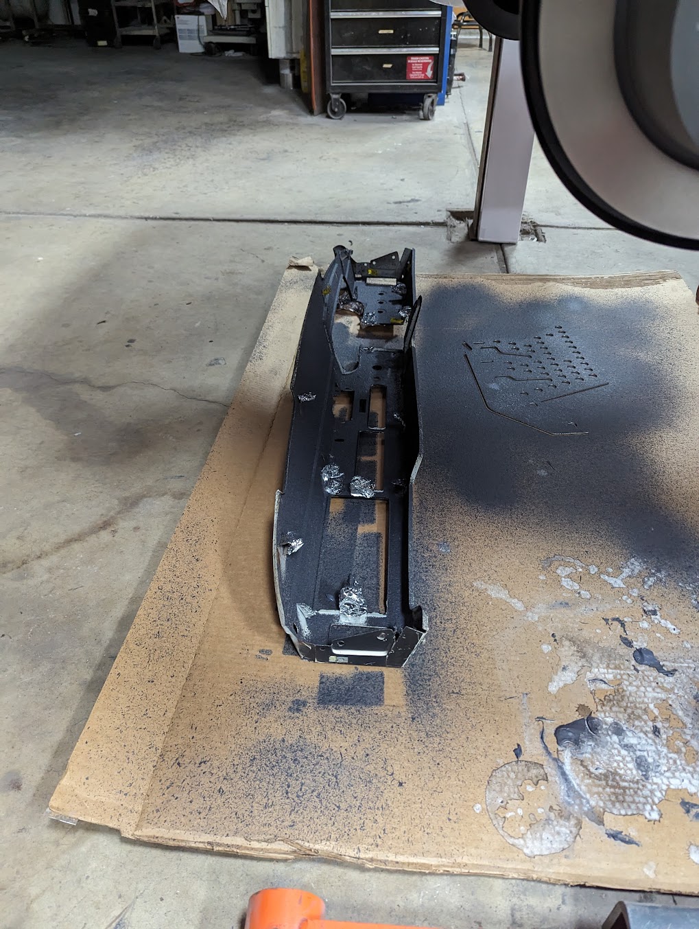

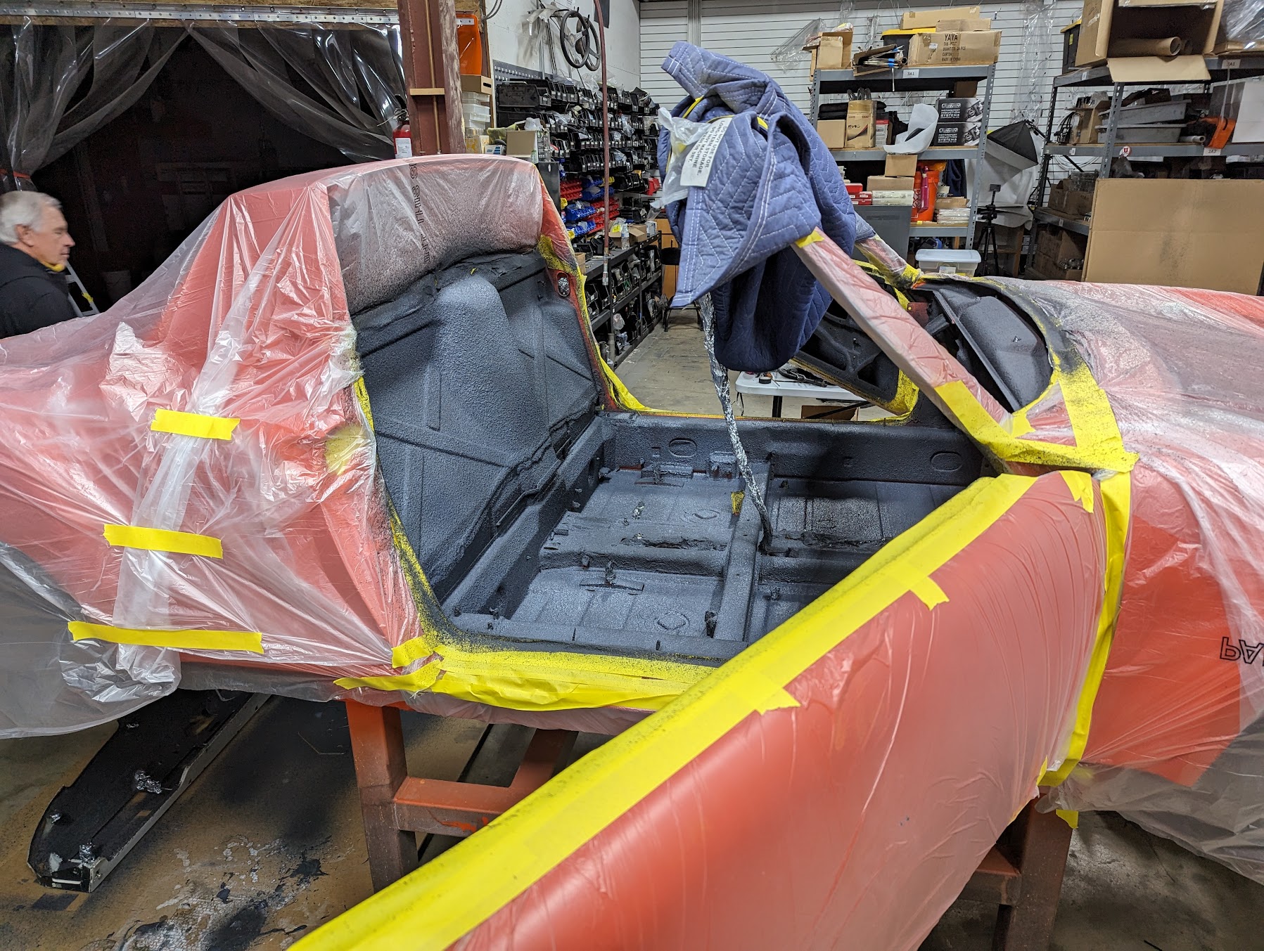

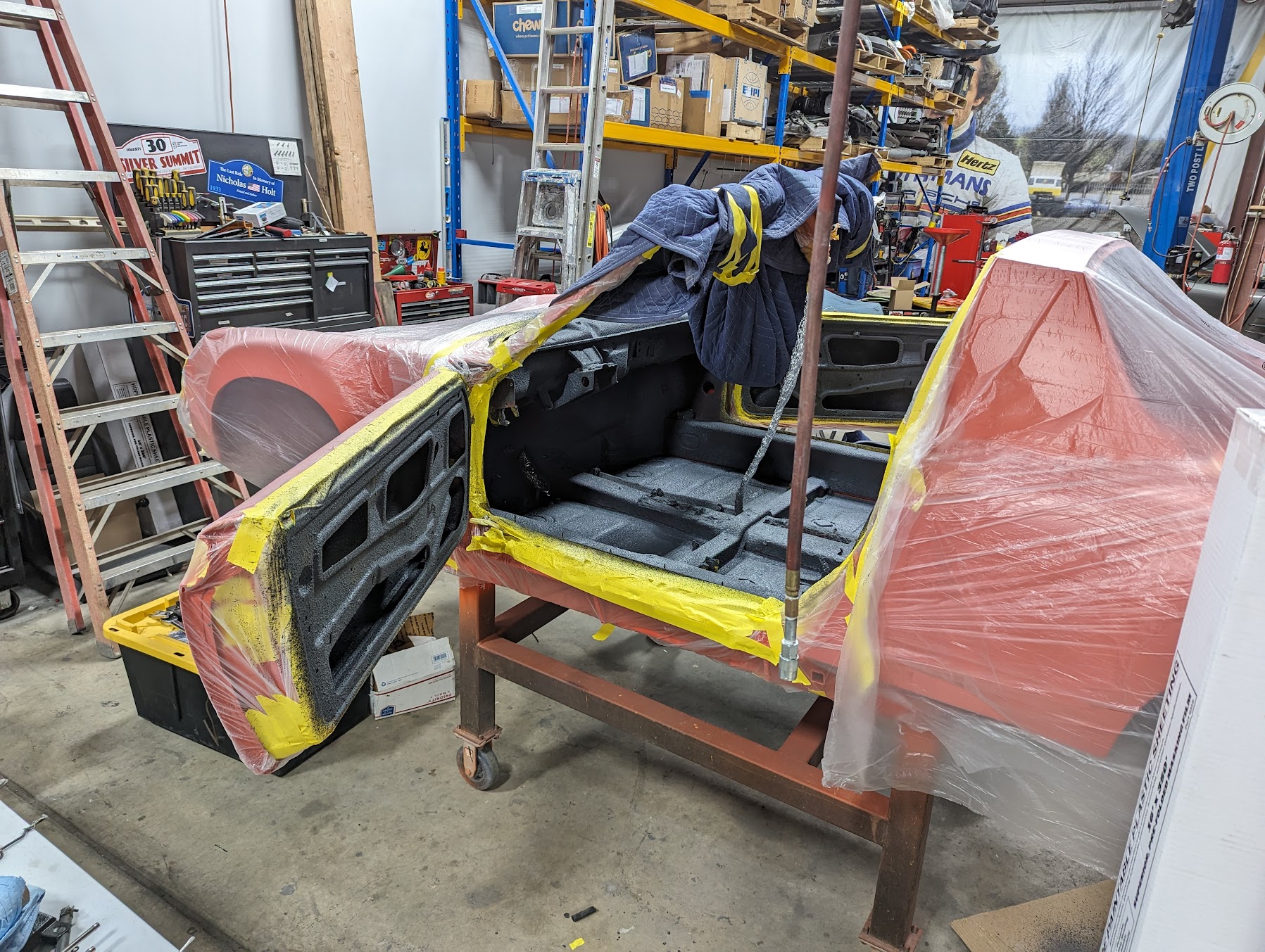

If you want to maximize sound comfort, before you put your rear window in completely strip your interior, tar boards and all, and spray every metal surface with Lizard skin including back side of the dash frame and pedal board (if you have a metal one). It takes all the resonance out of the cabin surfaces and gives the car a very solid, high end feel. Then you can add all your additional sound blocking pads back over the top of it.
Time consuming and not cheap, but worth it. I did it on my autocross car and even without adding any additional sound blocking on top of it made a huge difference, bonus it doesn't weigh very much.
