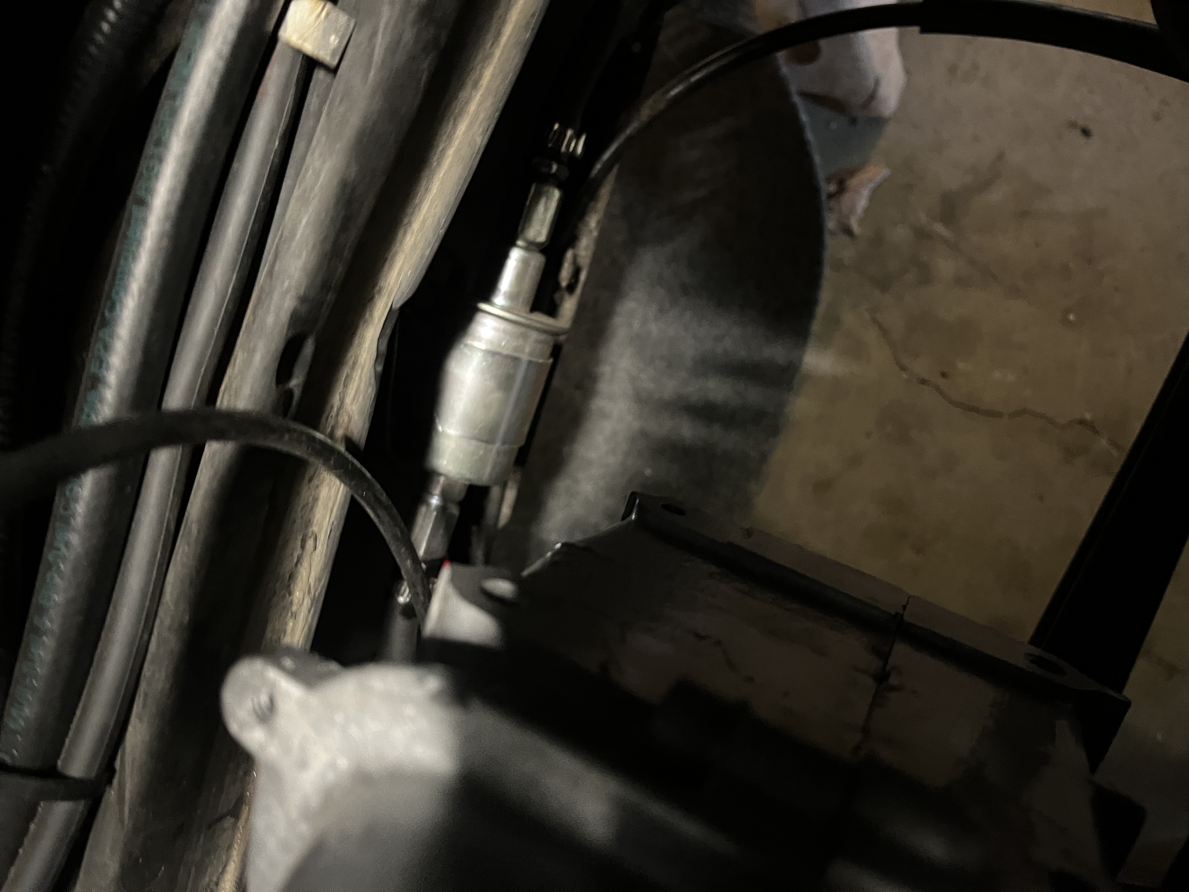

I would like some advice as to the best accelerator cable mount and location for a 74 type 4 i am working on. i've only owned fi so any help will help. Also is there a certain cable shroud part that holds the cable shroud to the mounting bar allowing little to no resistance for the cable to move freely. Thanks (IMG:style_emoticons/default/sawzall-smiley.gif)

there was a filter added and i noticed that the return line was not connected...should this return line be plugged? ThanksAttached Image work done by previous owner. i am just going throught the car now. ill look for the fpr and i will add one if it does not have one. (IMG:style_emoticons/default/aktion035.gif)

930cabman   your throttle cable needs a threaded end to secure...   Jan 11 2025, 06:43 PM
randyt914   i was wondering what the part looked like...and wh...   Jan 11 2025, 07:03 PM
randyt914   your throttle cable needs a threaded end to secur...   Jan 11 2025, 07:07 PM
Aerostatwv   914Werke has a picture of it mounted: https://914w...   Jan 11 2025, 08:32 PM
randyt914   I got her figured out thanks now I just need that ...   Jan 11 2025, 09:32 PM

Jack Standz   Yes, you can plug the return fuel line. But, it...   Jan 13 2025, 02:13 PM
randyt914   Yes, you can plug the return fuel line. But, it...   Jan 13 2025, 02:18 PM
