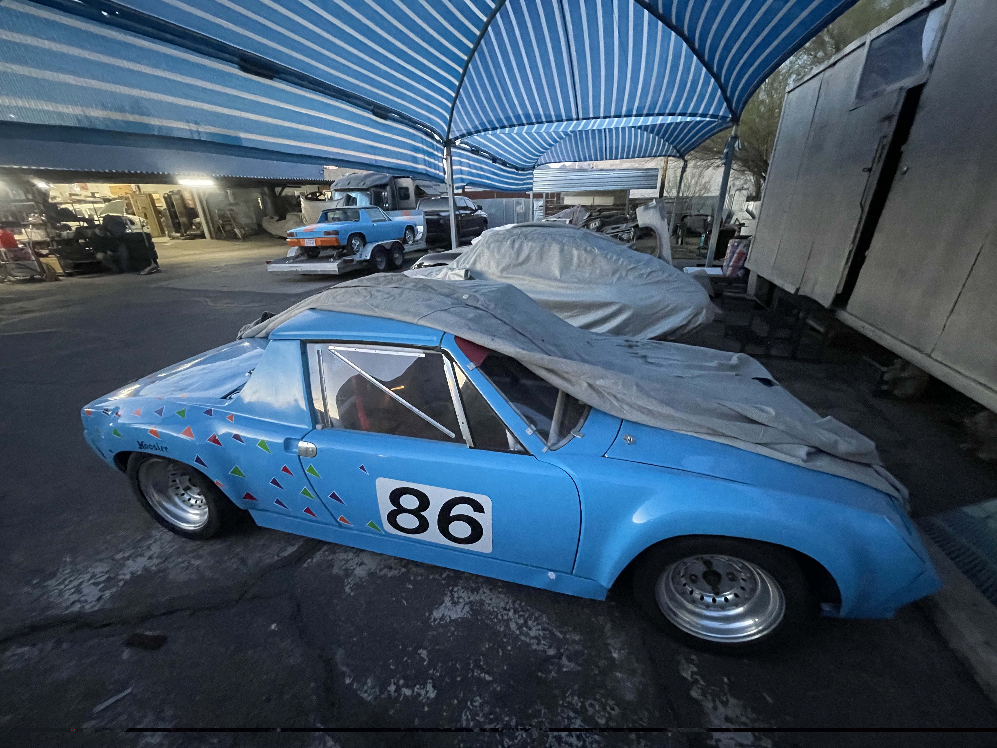

this is my motivation to finish ....71 2316 raby 1608lbs. Keyser rims. lsd....and the list goes on. Was an east coat scca car owned by The hansens then chris foley and greg amy and now its ALL MINE hahahah...Attached Image (IMG:style_emoticons/default/flag.gif)
