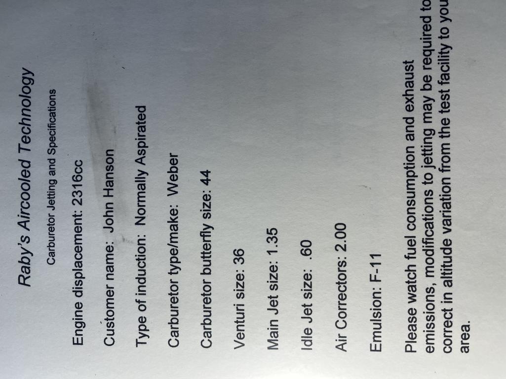

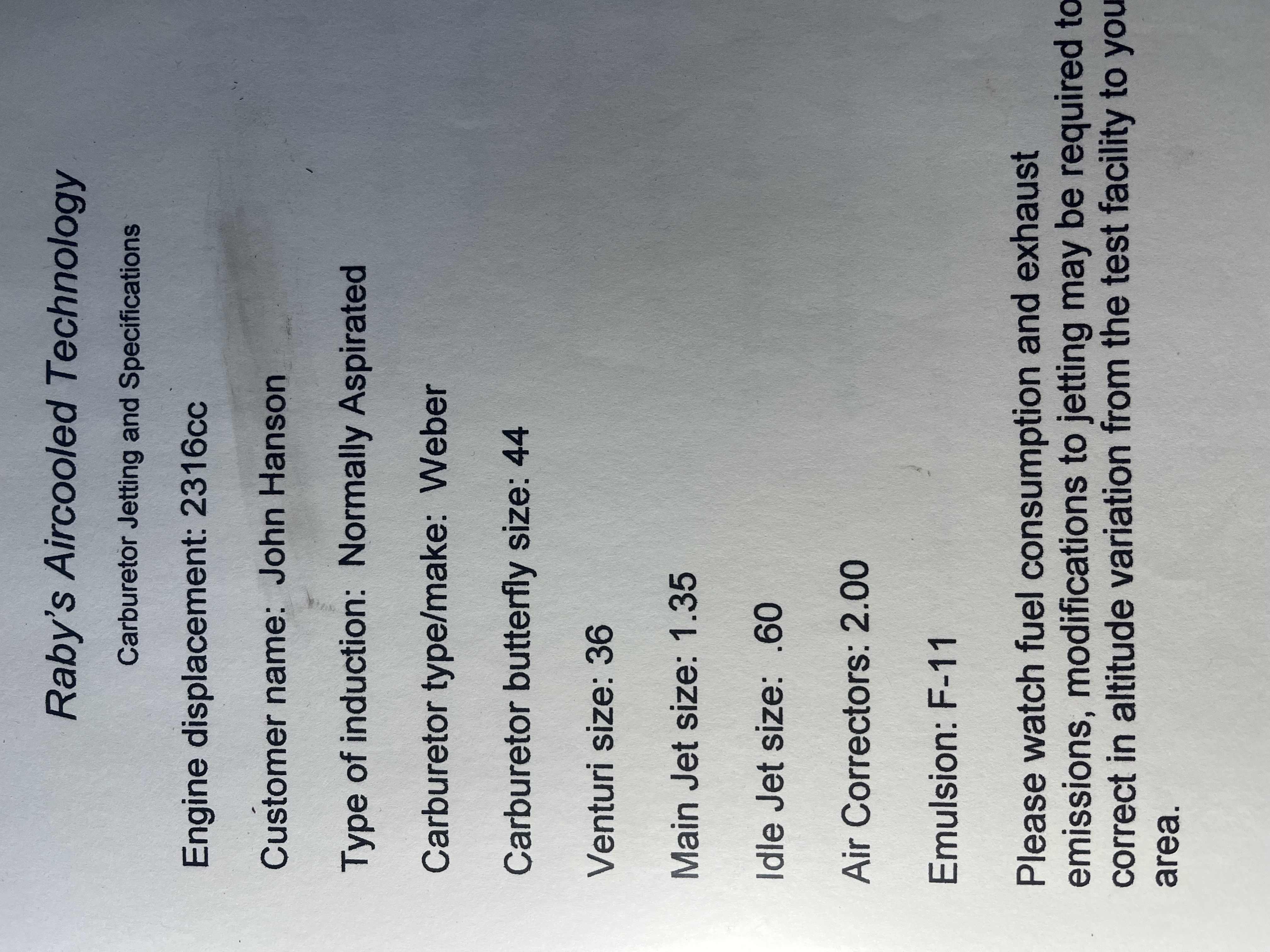

I'm sorry!
You have a serious build.
Your carbs may be much larger.
If they were speced by Raby I'd expect them to be well dialed in.
44s with 34-36 vents would be my guess.
Still needs the wideband but I would be very hesitant to make large changes to what Raby suggests.

randyt914
post Jan 13 2025, 04:52 PM
Posts: 124
Joined: 6-April 06
From: truckee ca
Member No.: 5,832
i hope to attend a 4 day class of jakes in late august and this will be a question i have to ask. btw the raby carb specs in photoAttached Image
