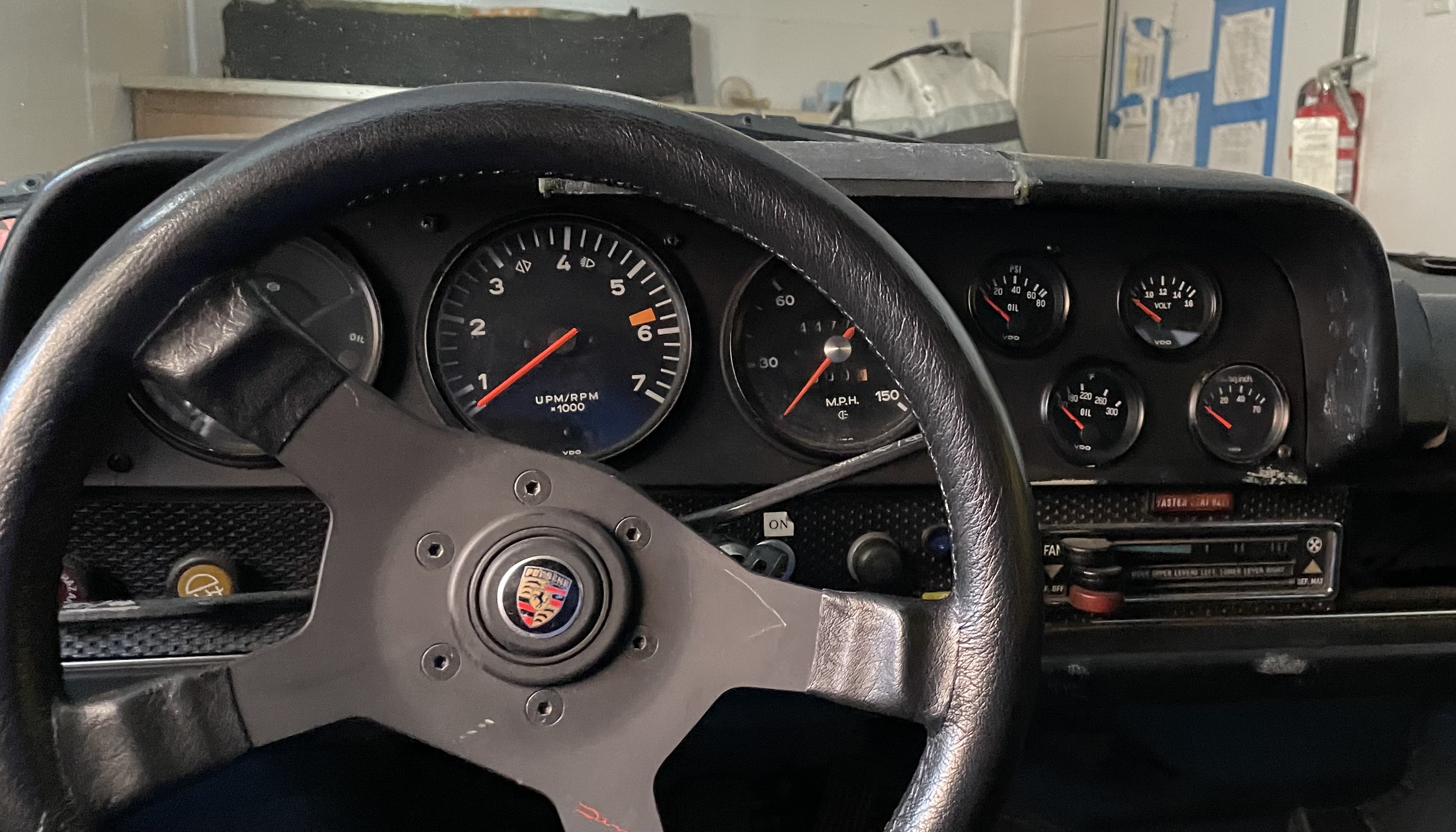

I removed my Center Console because I found the gauges were too low and I had to glance downward to see them. This caused me to loose a main bearing in a race as my Accusump did not turn on with the ignition as I designed it to, so I lost oil pressure in a corner.
Adding holes for 4 gauges at eye level allowed me to have 2" gauges for Oil Pressure, Oil Temperature, Volts, and Fuel Pressure. I found my engine cuts out when fuel level is low and I'm in a tight corner. This mod eliminates the Ash Tray (so what). I had to chop up the dash, kinda refit it to the right glove compartment side. I just shaped a piece of Balsa Wood to fill in over the gauges. Good enough for a race car. Could be made a whole lot nicer. For the gauge plate I had a local sheet metal guy make me from a cardboard template. Now I don't miss critical oil and gas level problems on the fly. |
