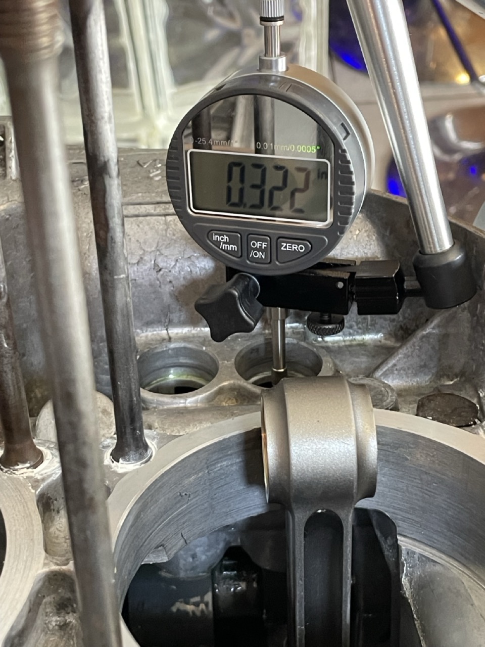

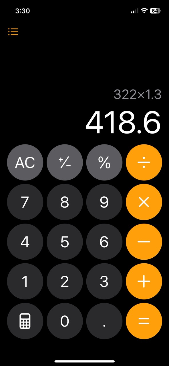

You can get those custom cut aluminum push rods from Germany. The same place that I bought my 10mm swivel feet adjusters from, offers them. I had already purchased the chromoly ones, so I didn’t get them. They say that they are much quieter and expand at same rate as factory, so they are better. Stateside tuning is the place to order if interested.
I did the base circle test on Saturday and it was successful, no movement on the cam lobe until the lobe starts it rise. The lift number on my 86a shows 436 lift on intake and exhaust side per the cam card, I’m only coming up with 418.6 ?
I had to stop there because when I pulled out my new Web lifters for the cam, I realized I was sent hydraulic lifters instead of solid ones. I’ll have to wait until I get the solid ones in before going any further with my build. I used one of my original lifters to do the test.
