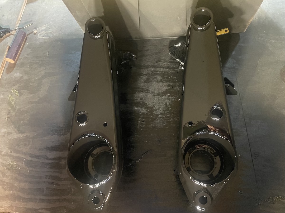

I ended up ordering a set of elephant racing rubber bushings and shafts for the trailing arms. While waiting for parts to arrive from the west coast I spent my time cleaning up and refinishing the trailing arms. With limited timely powder coating options in my area, and some impatience, I ended up stripping the arms down to clean shiny metal and spraying them with Eastwood chassis coat primer, and then their extreme chassis coat paint. They went from thoroughly nasty to looking good.
Random question, there was an angle bracket attached to each on the inside vertical edge (not pictured). What is the purpose of that bracket? Is there any reason to replace it?
This weekend I’ll get the bushings and bearings installed, then start cleaning up and refinishing the outer mount brackets while I wait for my threaded rear coilover kit to arrive.
