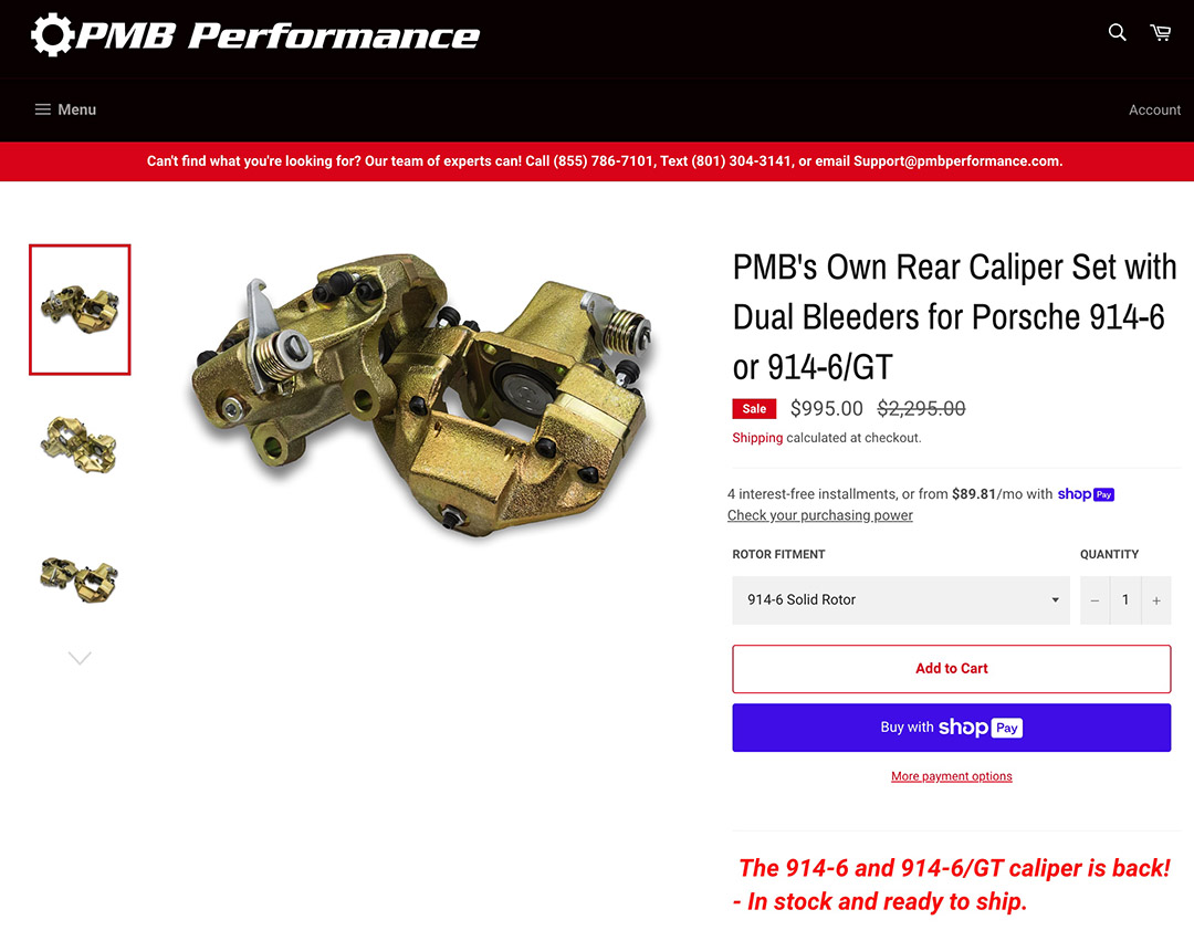

WFG You can still find 914 6 rear calipers just not as... Jan 17 2025, 02:47 PM
burton73 Point of reference: These are the trailing arms th... Jan 17 2025, 04:50 PM
technicalninja Whole bundle. 914-6GT and vented rotors/performanc... Jan 17 2025, 05:15 PM
