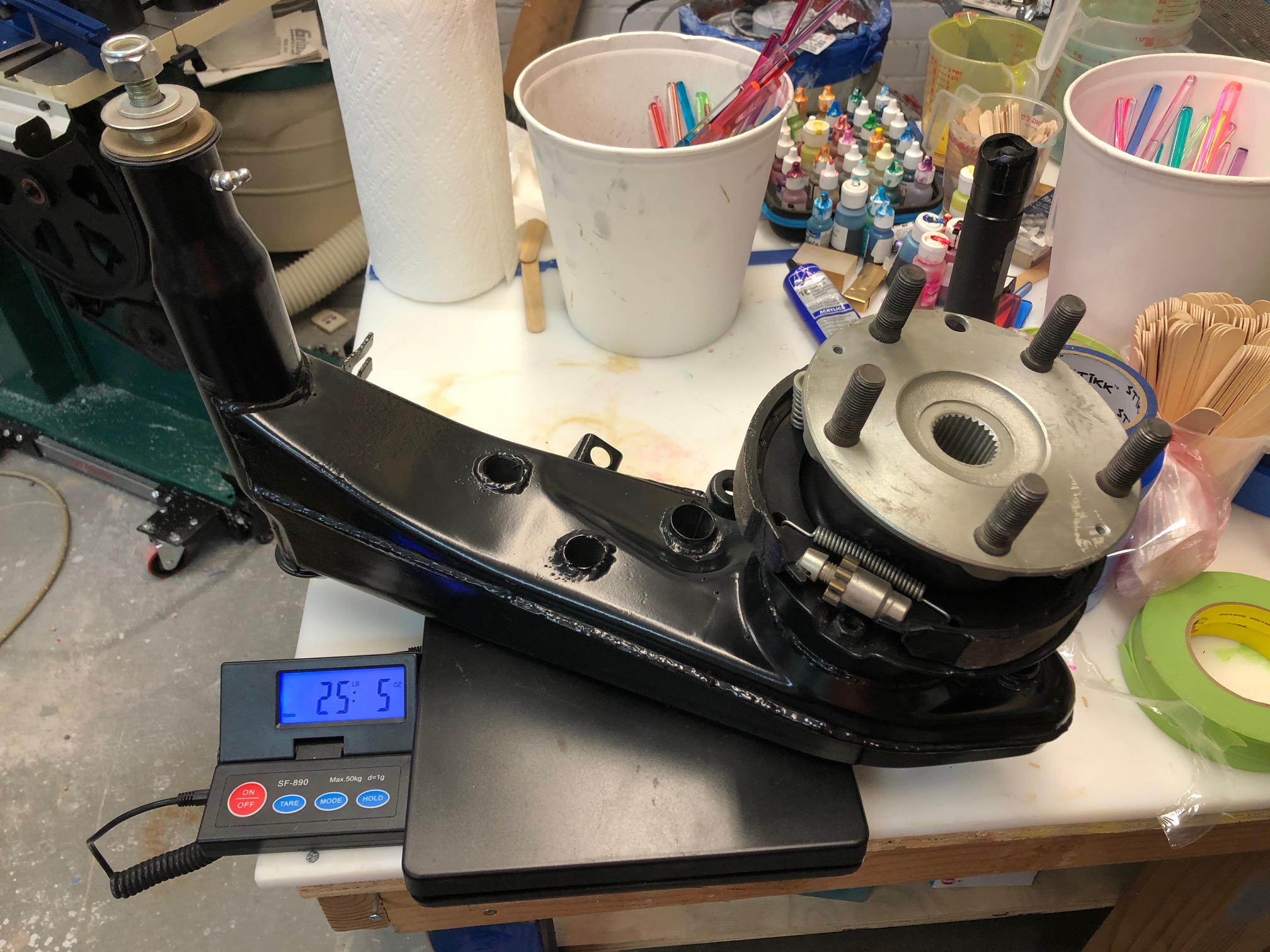

Senior member, and old dude ![]() ![]() ![]() ![]() Group: Members Posts: 3,989 Joined: 2-January 07 From: Los Angeles Member No.: 7,414 Region Association: Southern California
Point of reference: These are the trailing arms that Eric at PMB performance set up for me to use with my 930 transmission and a V8 car. Early 911 rear brakes and elephant Poly bronze bushing as well as strengthening of the trailing arm internally, you'll note there's 2 extra piece of pipe running through the trailing arm
Best Bob B |
