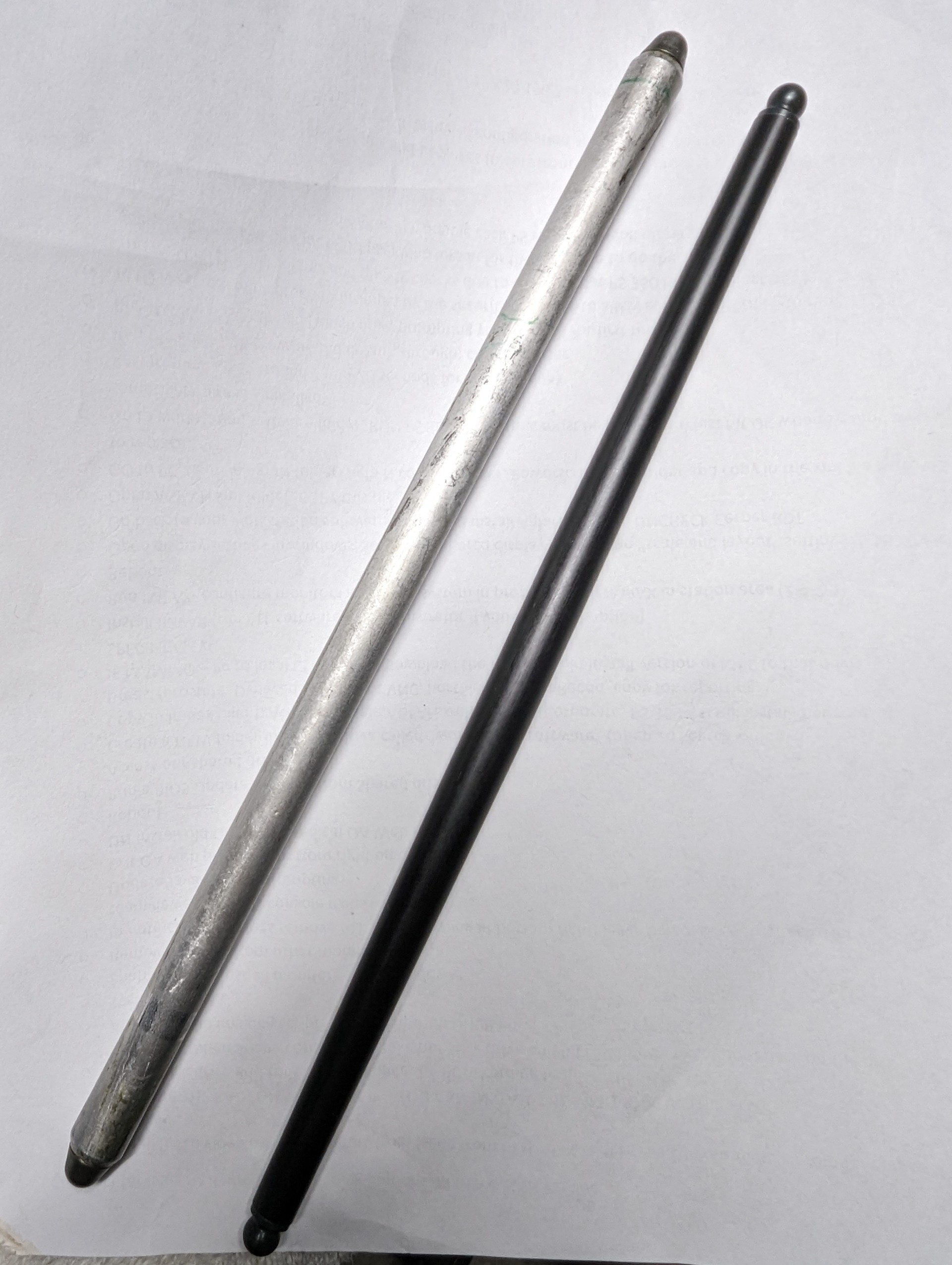

technicalninja   Just had a post from Jack Standz in my base circle...   Jan 10 2025, 04:17 PM

Chad911sc   You can get those custom cut aluminum push rods fr...   Jan 16 2025, 04:31 PM

rfinegan   let us know... CB has a set that look tempting ht...   Jan 18 2025, 06:19 PM
rfinegan   or this one... https://www.cbperformance.com/produ...   Jan 18 2025, 06:20 PM
