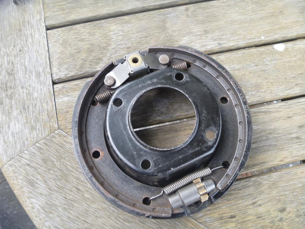

http://www.914world.com/bbs2/index.php?showtopic=4909 I used a thick piece of angle iron welded to the trailing arm, similar to a 911. In the article above they showed a modified 911 parking plate with a built in block. I would not recommend this unless you are just using it as a parking brake. In an emergency at speed I doubt that wimpy stop plate would prevent the shoes from braking loose and spin on the axle. |

There is a classic thread on this topic. http://www.914world.com/bbs2/index.php?showtopic=4909 I used a thick piece of angle iron welded to the trailing arm, similar to a 911. In the article above they showed a modified 911 parking plate with a built in block. I would not recommend this unless you are just using it as a parking brake. In an emergency at speed I doubt that wimpy stop plate would prevent the shoes from braking loose and spin on the axle. (IMG:style_emoticons/default/agree.gif) long story short I had that failure and it makes a hell of mess ,destroyed a whole bunch of parts including smashing the stop plate eye off where the cable passes to the spring return plates ,managed to repair that part, took a while to find parts used but located them from Retro Automotive and they were kind enough to send me a few extra parts free of charge. I was pissed off as the PO told me the system worked fine , that was BS and no stop plates had been welded on to the trailing arms , luckily it only happened on one side as the cable was out of adjustment on the other side so no other damage done . Cheers. |
