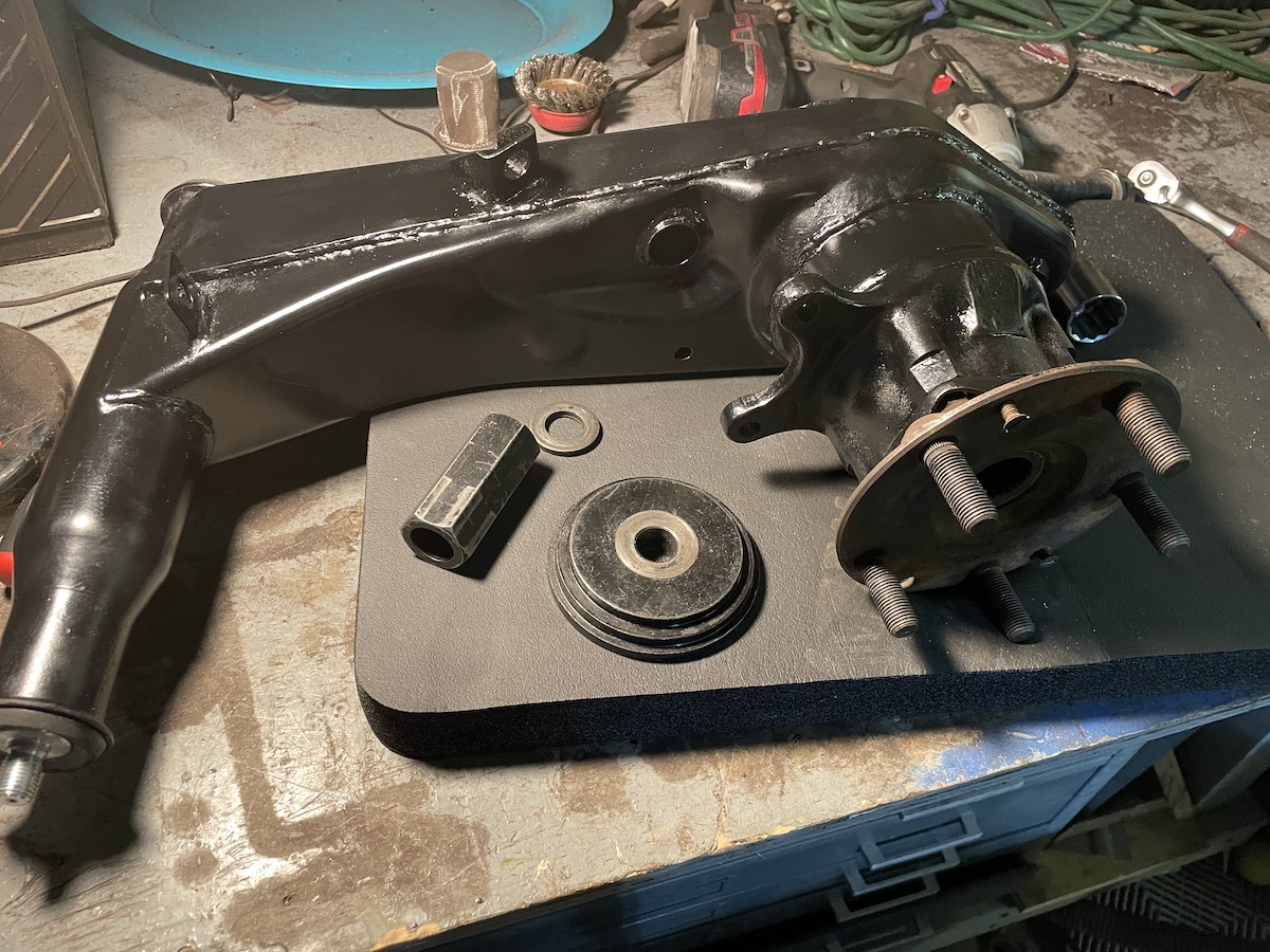

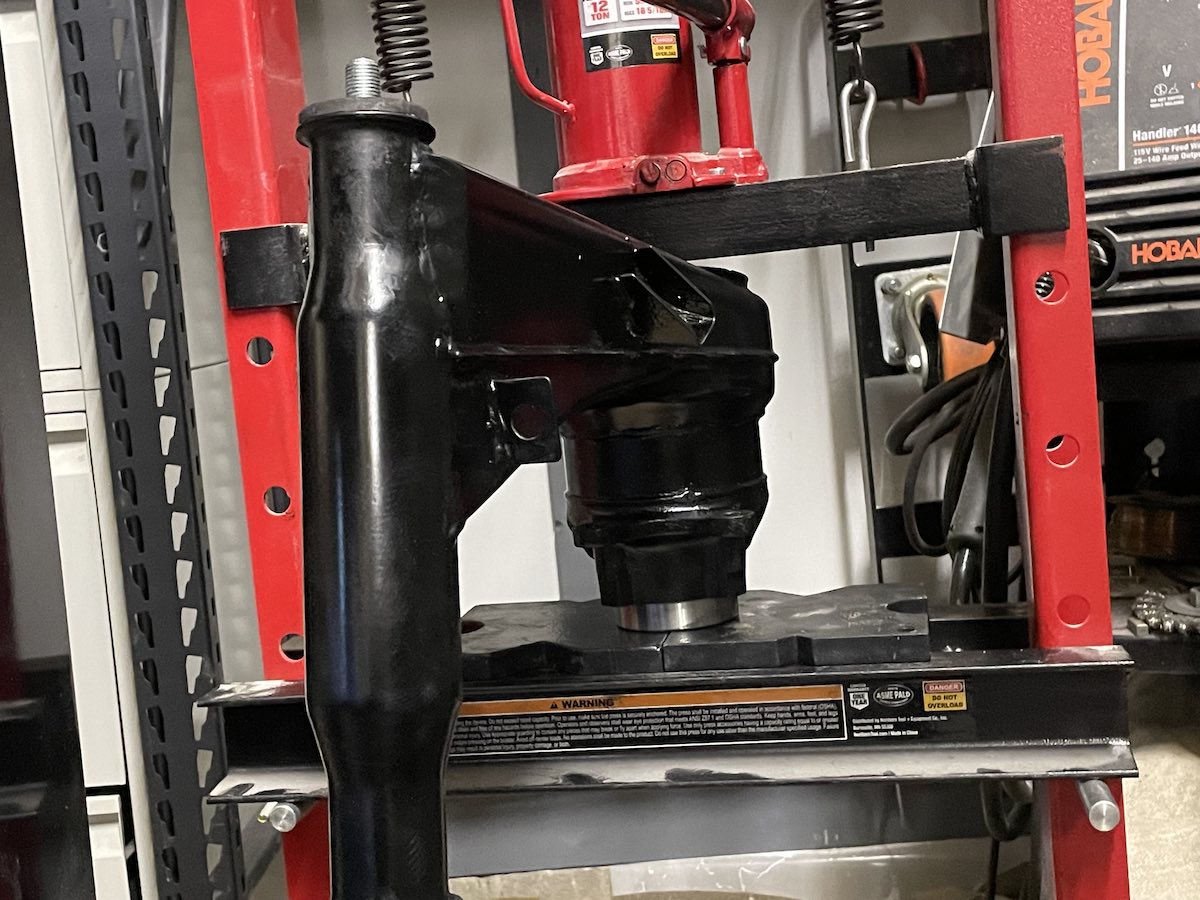

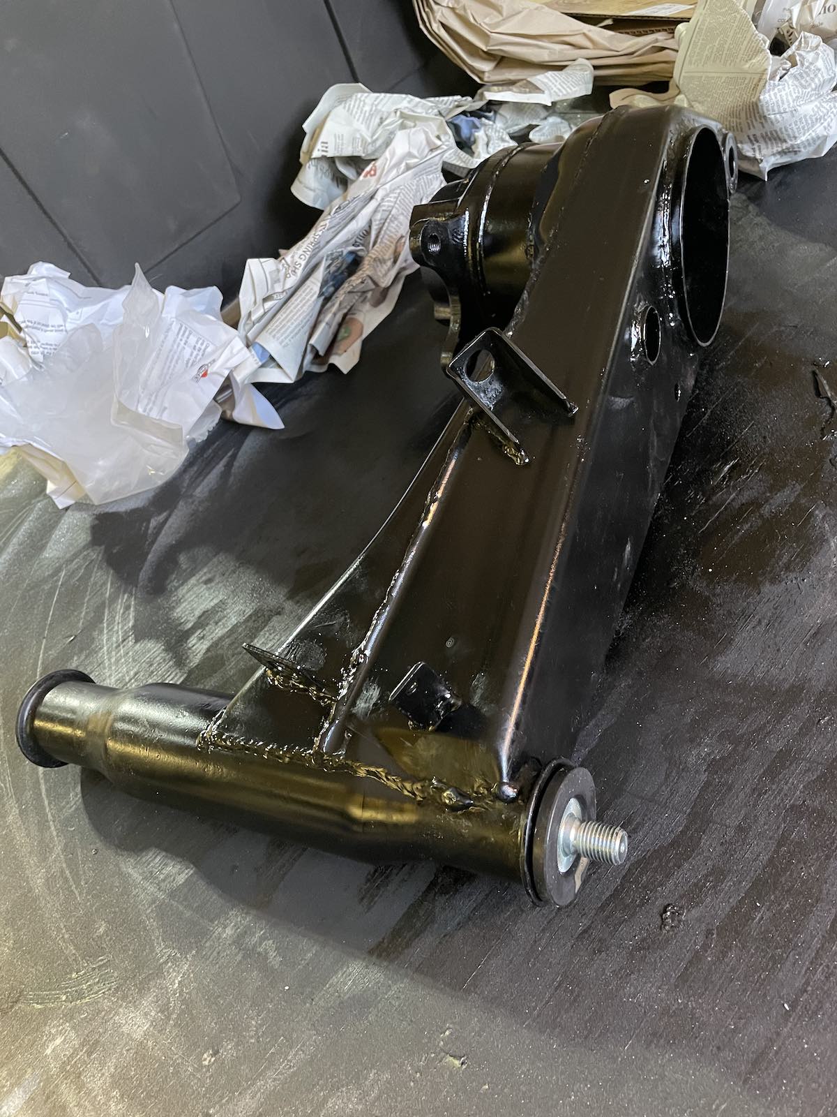

With my trailing arms freshly painted, it was time get them out of the dining room and put them back together. The rarely used shop press got a bit more use pressing the new shafts in.
From there I got the wheel bearings installed.
I made quick work of getting the bearing retainer plates back on and pulled the hubs back into place.

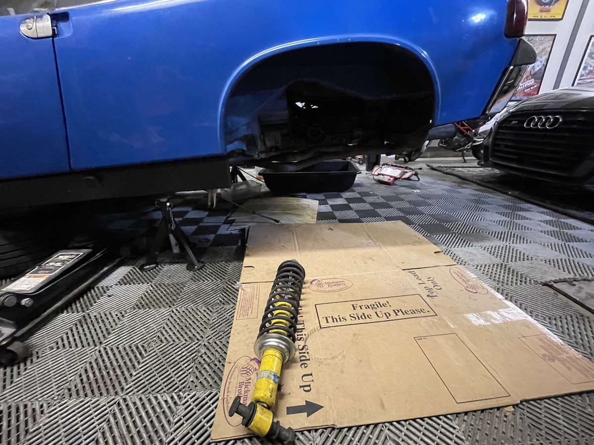

I also got the rear shock assemblies removed in anticipation of threaded coilover collars arriving in the mail sometime this week. I intended to use Rebel Racing threaded collars, but Tarett was out of stock. Despite having had good service actually working through client at Rebel Racing in the past, I figured I wouldn't push my luck and hence trying to order through Tarett. Being unsuccessful, I ended up ordering collars from Ground Control. That's what I have on my track car, so I know they'll work as intended on the street car.
Next up....reinstalling the trailing arms.
