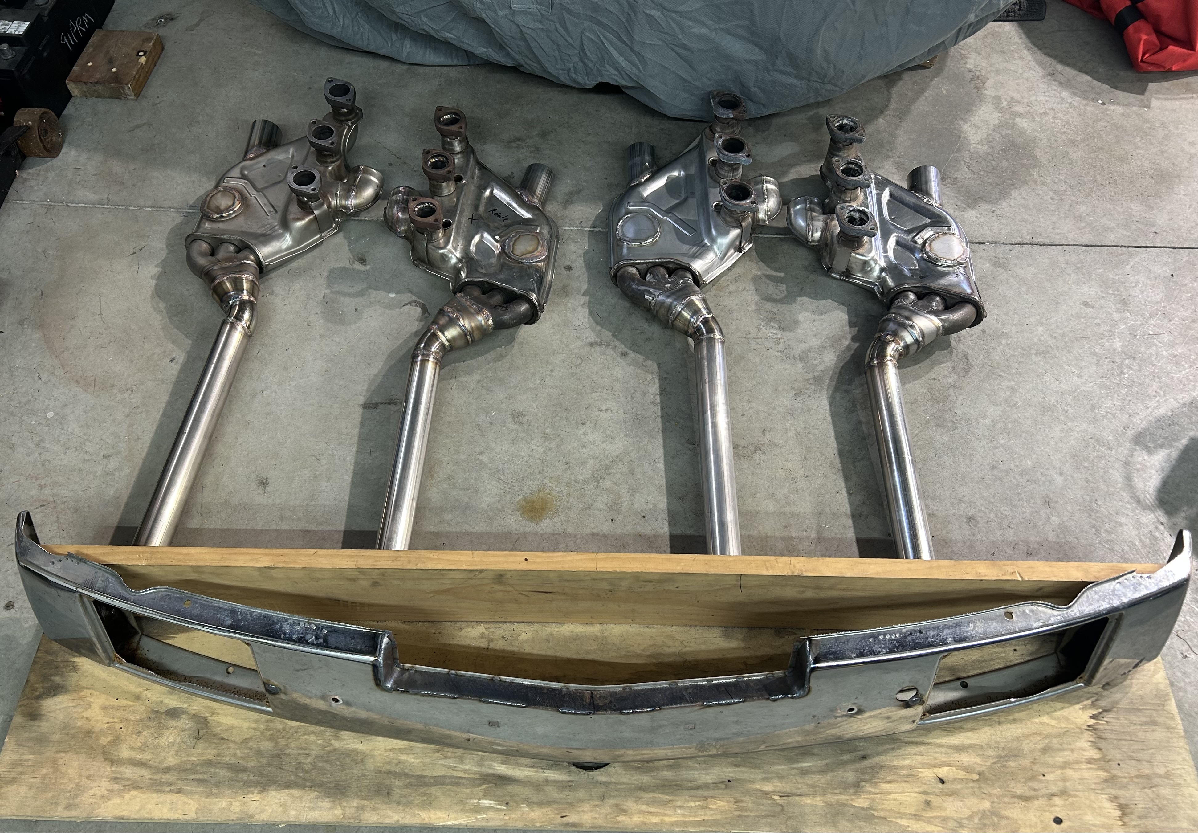

Another 2 sets and a GT bumperAttached Image

Steve   :beer2: That is awesome!! Thanks for doi...   Jan 21 2025, 11:10 AM
mb911   I am happy to be able to offer them.   Jan 22 2025, 12:45 PM
