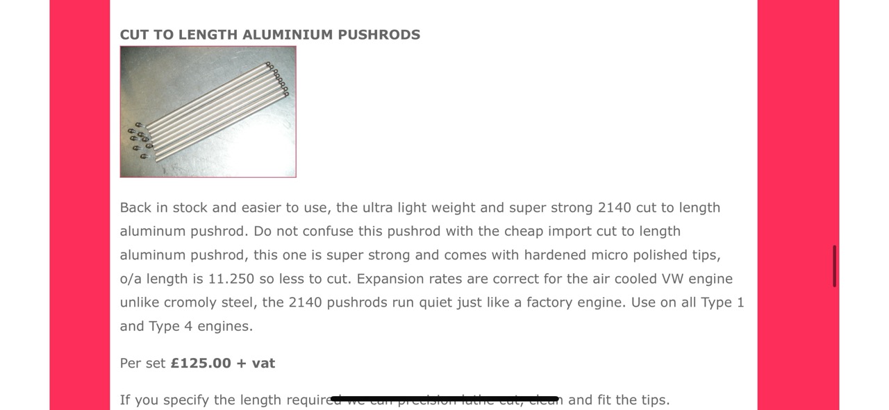

Chad911sc   You can get those custom cut aluminum push rods fr...   Jan 16 2025, 04:31 PM

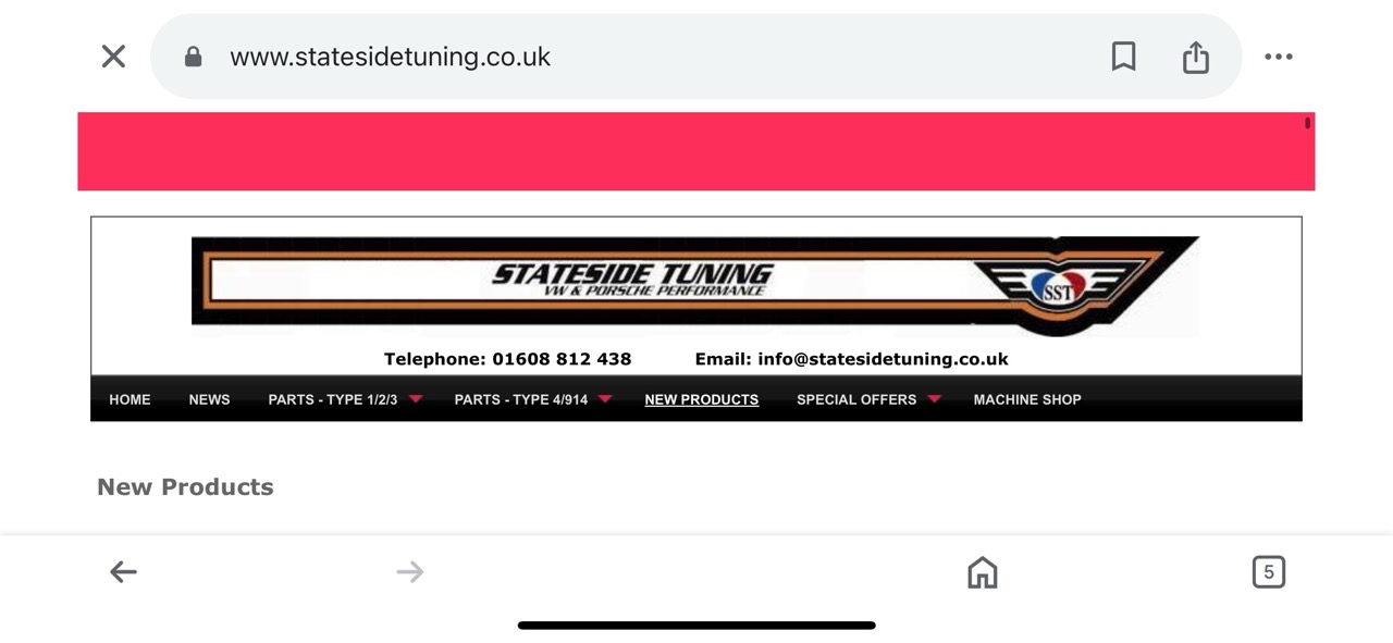

Chad911sc   Stateside tuning has these available now. It only ...   Jan 23 2025, 04:17 PM
