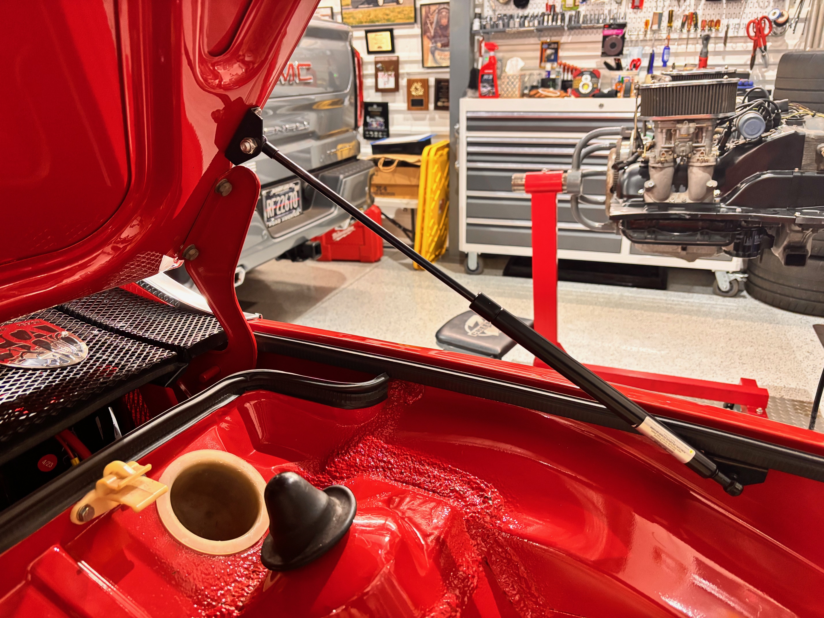

New shocks I just installed.

Lof8   Can someone who has these installed on their car t...   Jan 24 2025, 07:25 AM
SKL1   New shocks I just installed.   Jan 24 2025, 02:39 PM

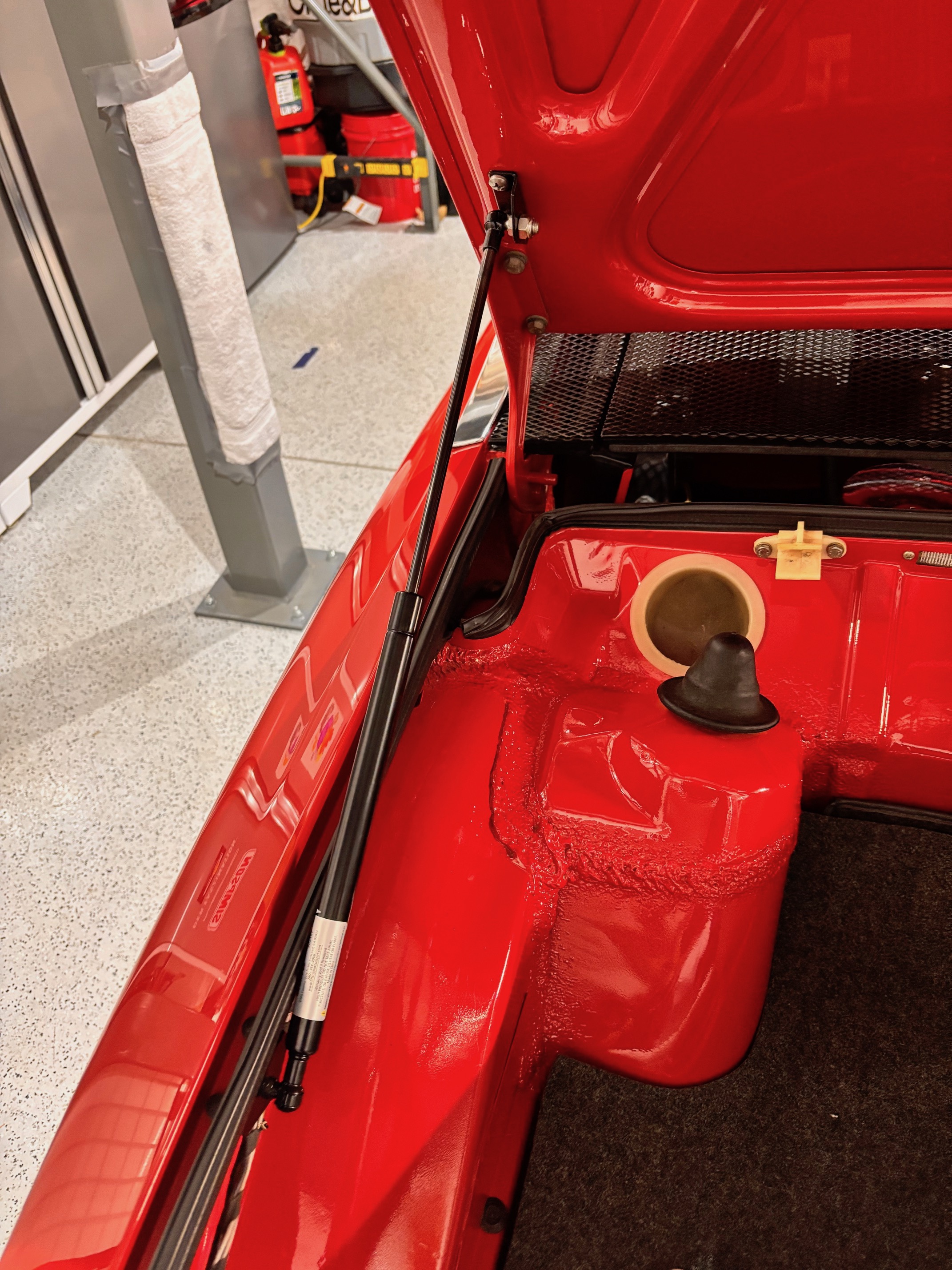

East coaster   A pic of mine during construction….   Jan 24 2025, 08:06 PM
