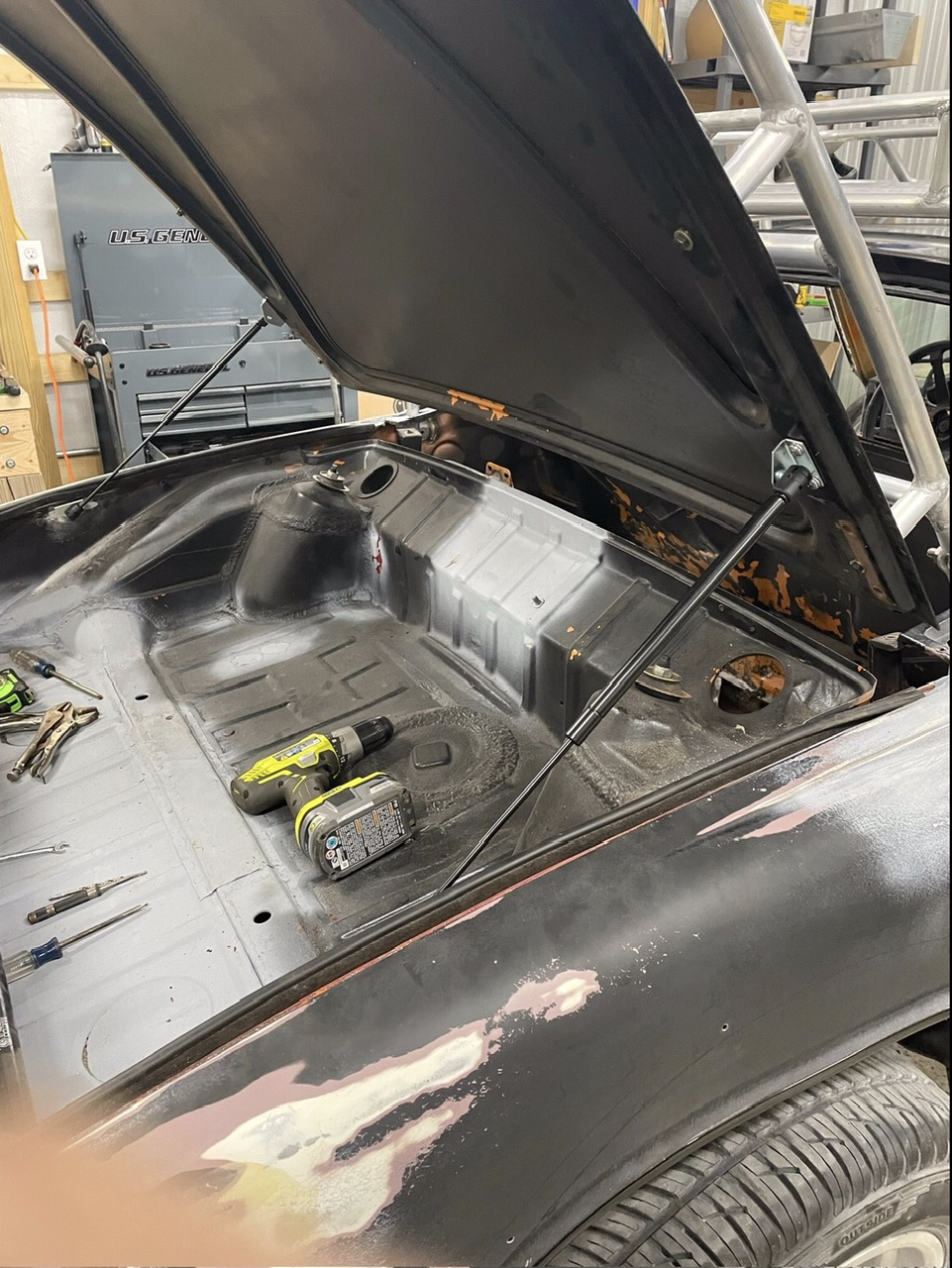

A pic of mine during construction….

East coaster   A pic of mine during construction….   Jan 24 2025, 08:06 PM
