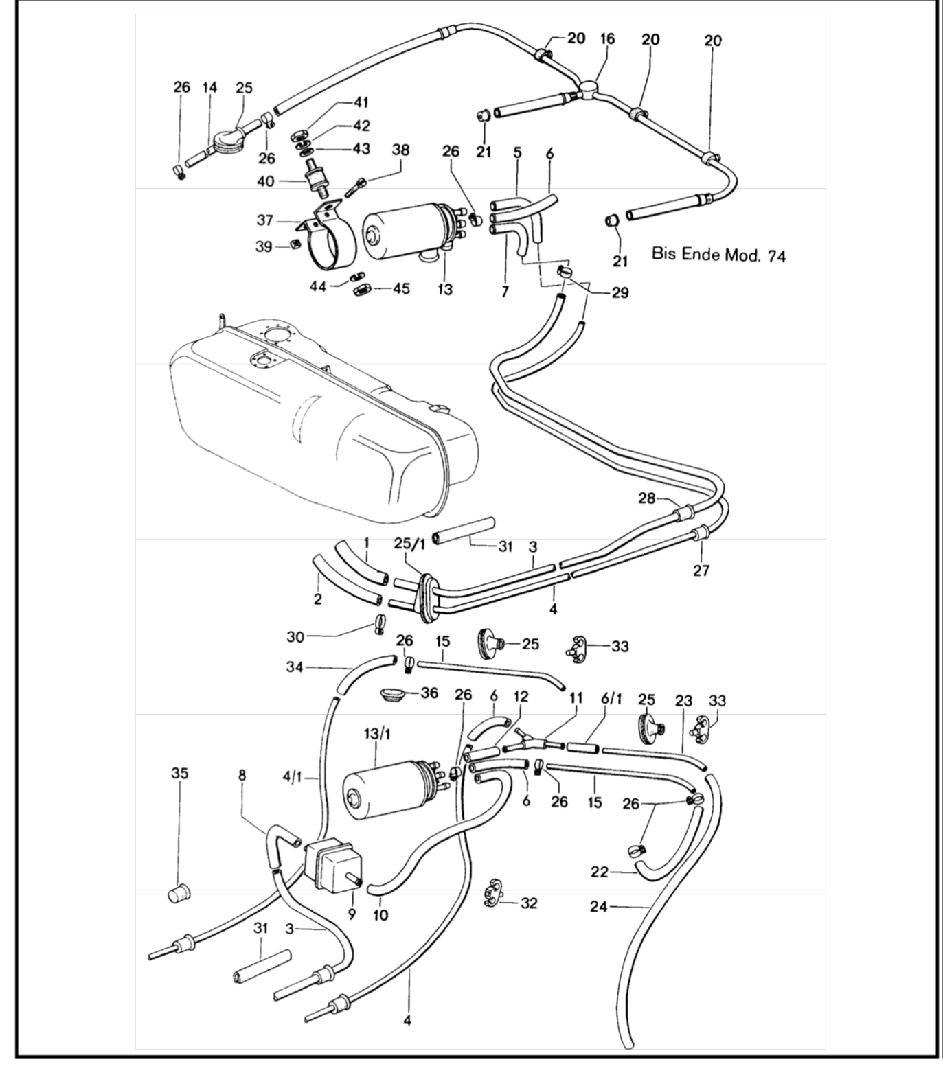

Looking for the front fuel line grommet for my 1970.. Somehow misplaced mine and I can't seem to find one new.. It is the one with openings for both fuel lines to go through.
part no. 91435654300 also labeled 25/1 on a few diagrams I have seen.

Its the same grommet used for the plastic brake pipes VW# 111 957 861
I don't believe it changed to the large single grommet until late 74 possibly 75 when the pump got moved up front.
This is on an early 914-6 for reference

I was searching through my boxes of salvage looking for this. My car is a six, and the PET shows it using the late grommet with the two holes. I thought I’d lost it. Looking at the bulkhead under the tank it clearly has the two smaller holes, so the PET is wrong.
I really appreciate this thread, I could have gone down a rabbit hole on this one.
