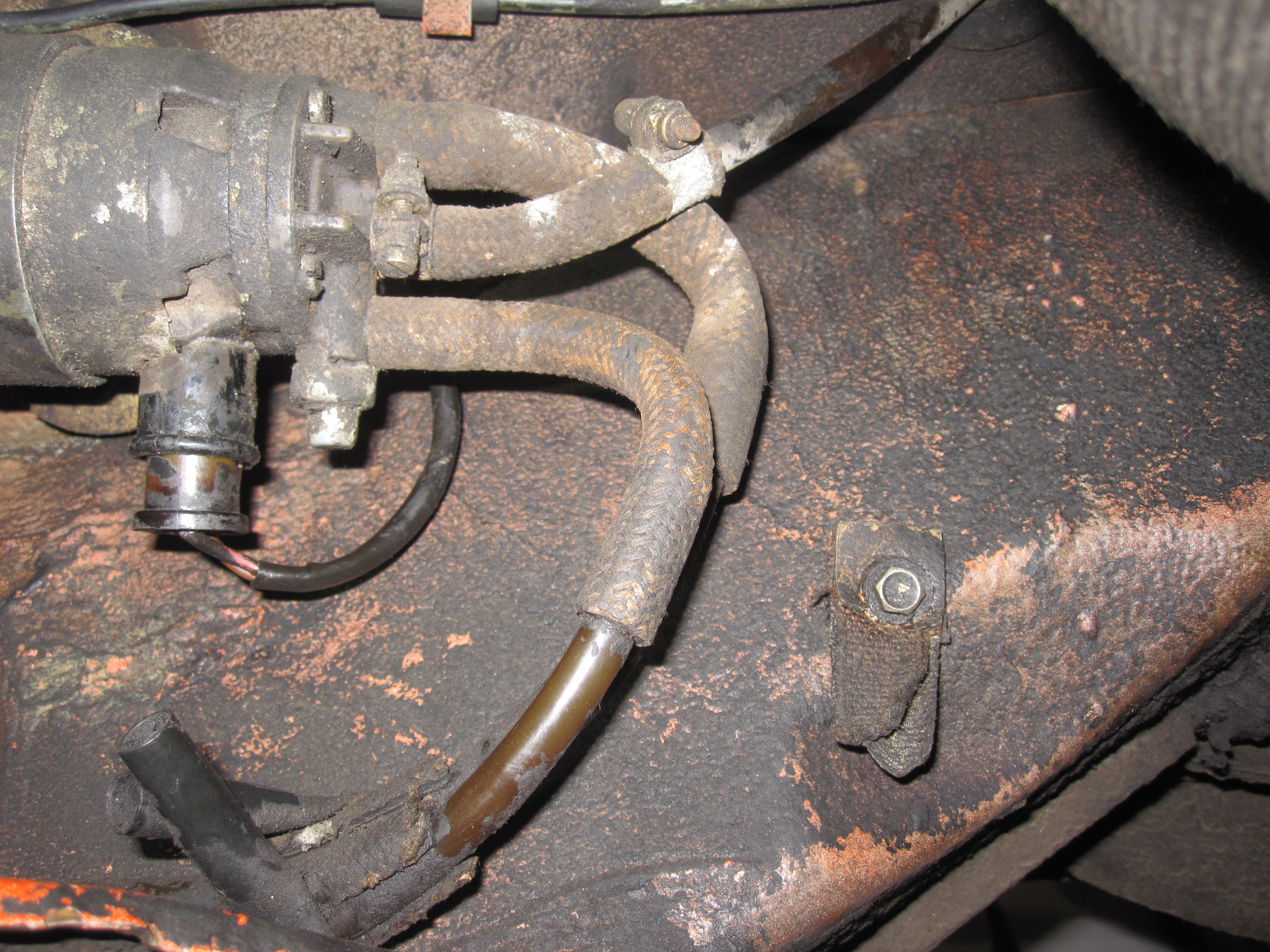

QUOTE(rgalla9146 @ Feb 9 2025, 06:07 PM) *
the other example 914 043 1467
The factory used 7 and 9 mm hose over 8 and 10 mm fittings, the hose stretched considerably and was a pretty tight fit. They didn’t appear to feel the need for hose clamps on unpressurized lines as we’ve seen here, and I am not aware of it ever being a problem.
I’m putting hose clamps on everything, though. Originality be damned.

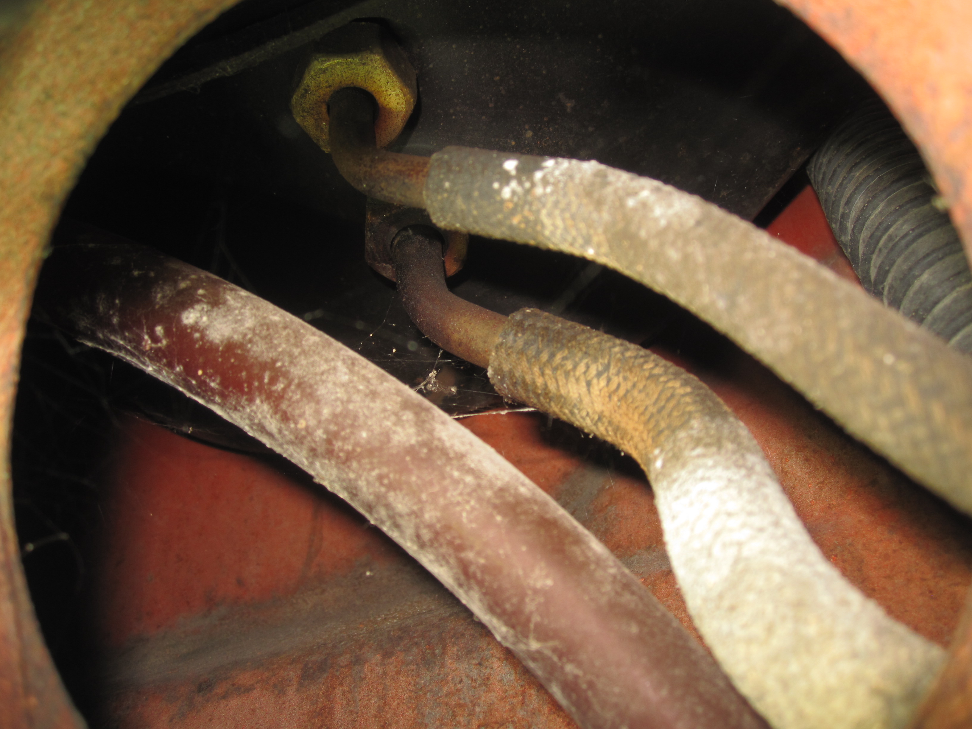

rgalla9146   fuel pump hoses as found. Sorry for adding th...   Feb 9 2025, 10:50 AM
