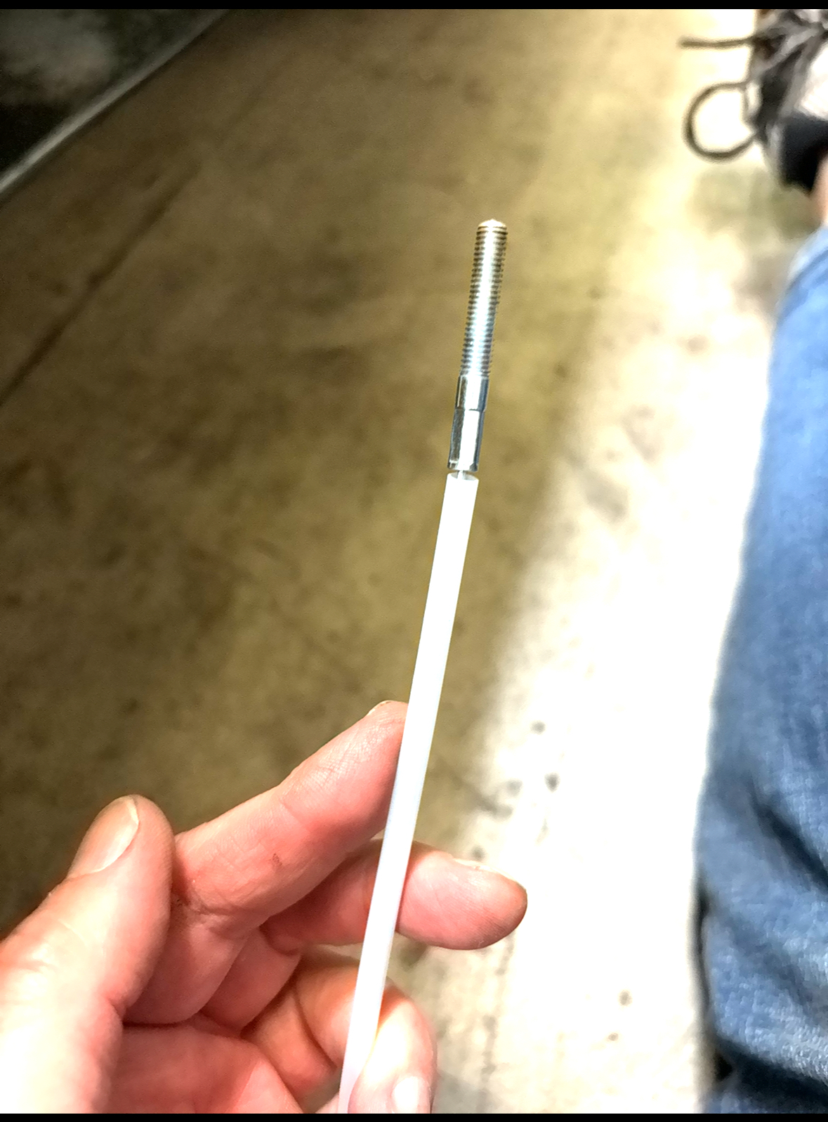

The replacement accelerator cable won’t fit into the opening with the blue arrow.
Can’t see anything stuck I the opening and the old cable came out OK. The old cable did not have the white sheath, but that should make a difference because that isn’t wider than the top of the cable that the ball cup screws on to.

Tdskip   Any chance the replacement cables have larger fitt...   Mar 25 2025, 06:28 PM
Superhawk996   Any chance the replacement cables have larger fit...   Mar 26 2025, 07:31 AM

Tdskip   OK - got it! In the end it was the tube being...   Mar 26 2025, 01:08 PM
