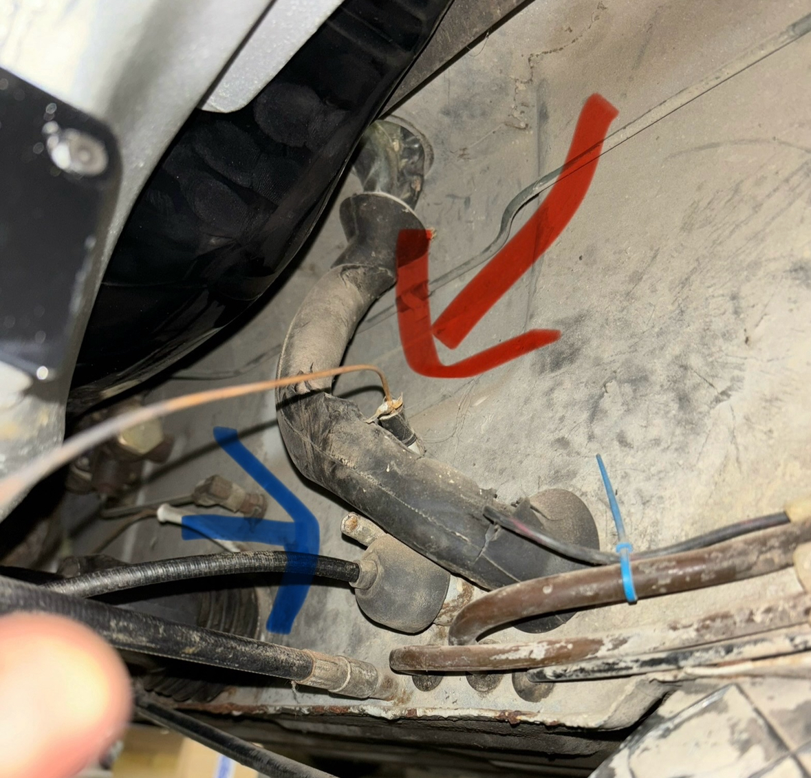

OK, once more with feeling….
This is the 74 that had the misrouted accelerator cable. That has been removed so now I have what I believe is the original accelerator cable, the arrow is pointing at it, which is good in stock in the tunnel.
Even with vice grips on it, I can’t pull it out and it doesn’t really wanna move forward either.
I’m going to have to remove this before I install replacement cable so any ideas or suggestions?

Oh man? This poor car and somewhat clueless current owner (me)
Cable should run through where the blue arrow is pointing?

QUOTE(Tdskip @ Feb 10 2025, 02:35 PM) *
The blue arrow is the correct location for the throttle cable.
It may have the remains of the cable sheath in it. I would start with a coat hanger wire and try cleaning it out.
