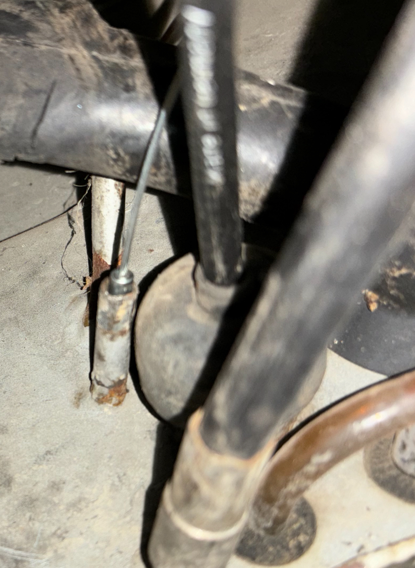

OK, once more with feeling….
This is the 74 that had the misrouted accelerator cable. That has been removed so now I have what I believe is the original accelerator cable, the arrow is pointing at it, which is good in stock in the tunnel.
Even with vice grips on it, I can’t pull it out and it doesn’t really wanna move forward either.
I’m going to have to remove this before I install replacement cable so any ideas or suggestions?

ClayPerrine   That's not the hole for the accelerator cable....   Feb 10 2025, 02:19 PM
Craigers17   Disregard based on Clay’s answer.   Feb 10 2025, 02:21 PM
ClayPerrine   And I will add that is definitely not the throttle...   Feb 10 2025, 02:25 PM
Tdskip   Oh man? This poor car and somewhat clueless curren...   Feb 10 2025, 02:35 PM
ClayPerrine   Oh man? This poor car and somewhat clueless curre...   Feb 10 2025, 03:59 PM
Jamie   Oh man? This poor car and somewhat clueless curr...   Feb 10 2025, 08:47 PM

rjames   I can't remember how long the tube from the fi...   Feb 10 2025, 05:05 PM
Tdskip   Thanks Robert. I’m sure there will be other issu...   Feb 10 2025, 06:13 PM
Dave_Darling   Photos of what is inside the tunnel can be found h...   Feb 10 2025, 07:44 PM
rjames   Photos of what is inside the tunnel can be found ...   Feb 10 2025, 09:23 PM
aturboman   I ran into the same issue once on a car that sat f...   Feb 11 2025, 10:41 AM
Tdskip   Oh wow, good catch. I really appreciate the time y...   Feb 11 2025, 06:32 PM
