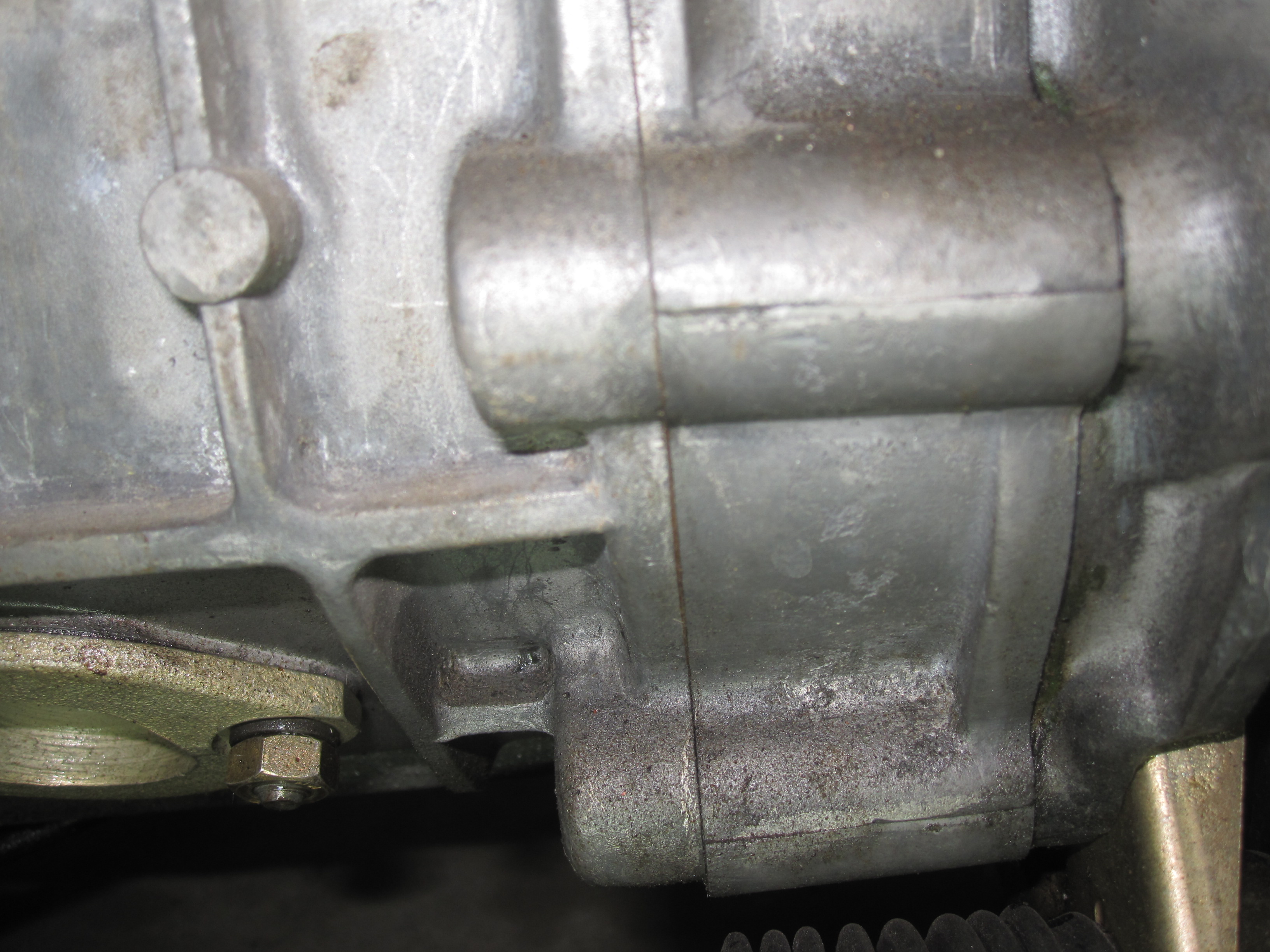

Those are not cracks. They are shadows from casting flash.

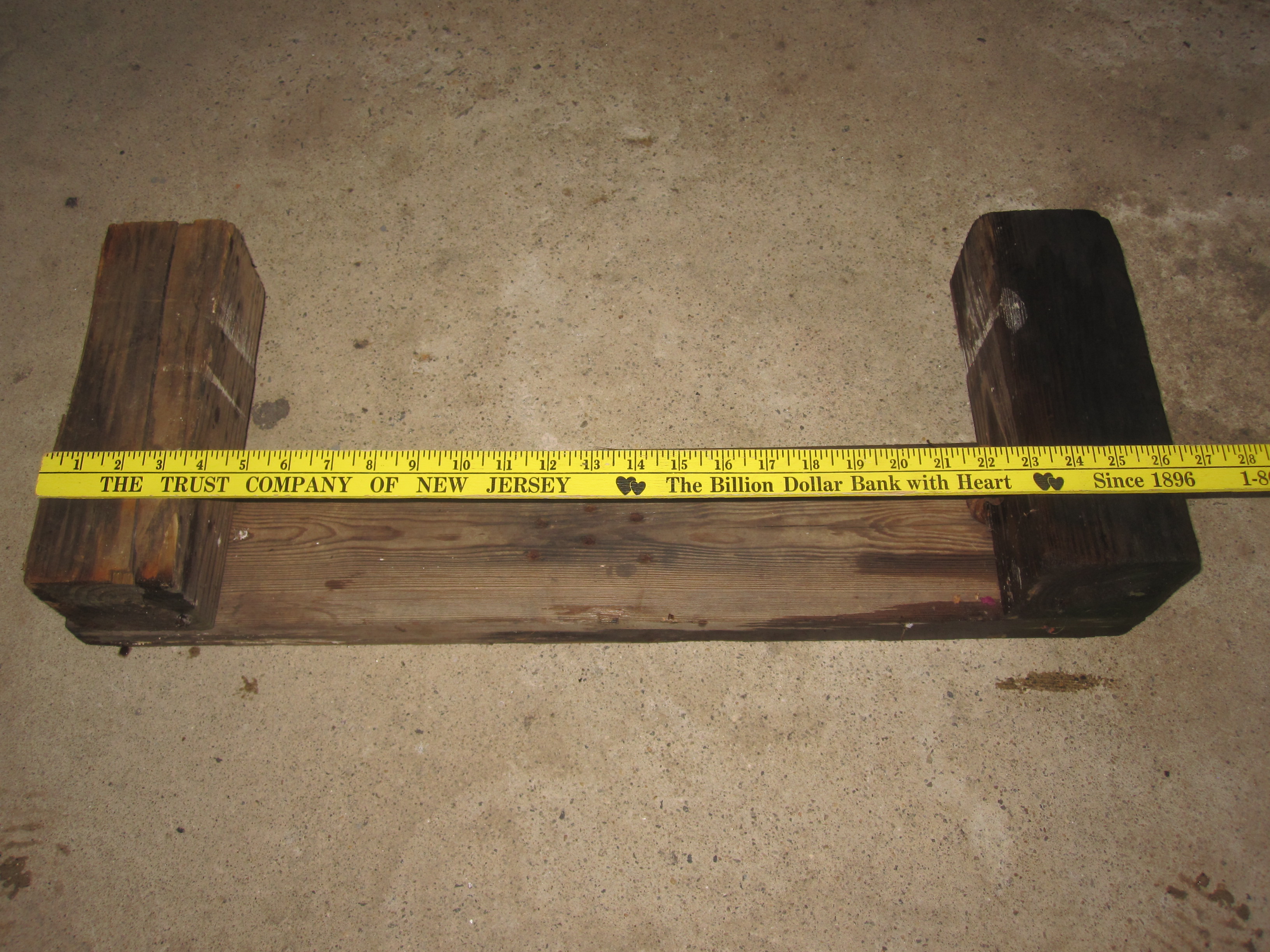

I used this assembly on a floor jack to remove /install engine and trans. with
HE's removed.
It was nearly balanced front/rear, left/right with the 4x4s extending forward and the
jack cup centered. The 4x4 are 10" A wood disc could be added to the bottom
of the 2x6" cross board to keep it centered.

Yes, I have the transmission apart and those “cracks” are indeed cast-flashing
Everything looks good on the inside, going to change 1st and second sync rings, perhaps 2nd/3rd slider and will take a look at dogteeth on 2nd

Hello,
if you want to look for cracks, you have to take a look at the top!
There are cracks at 911 or 914 transmissions...
Harald
