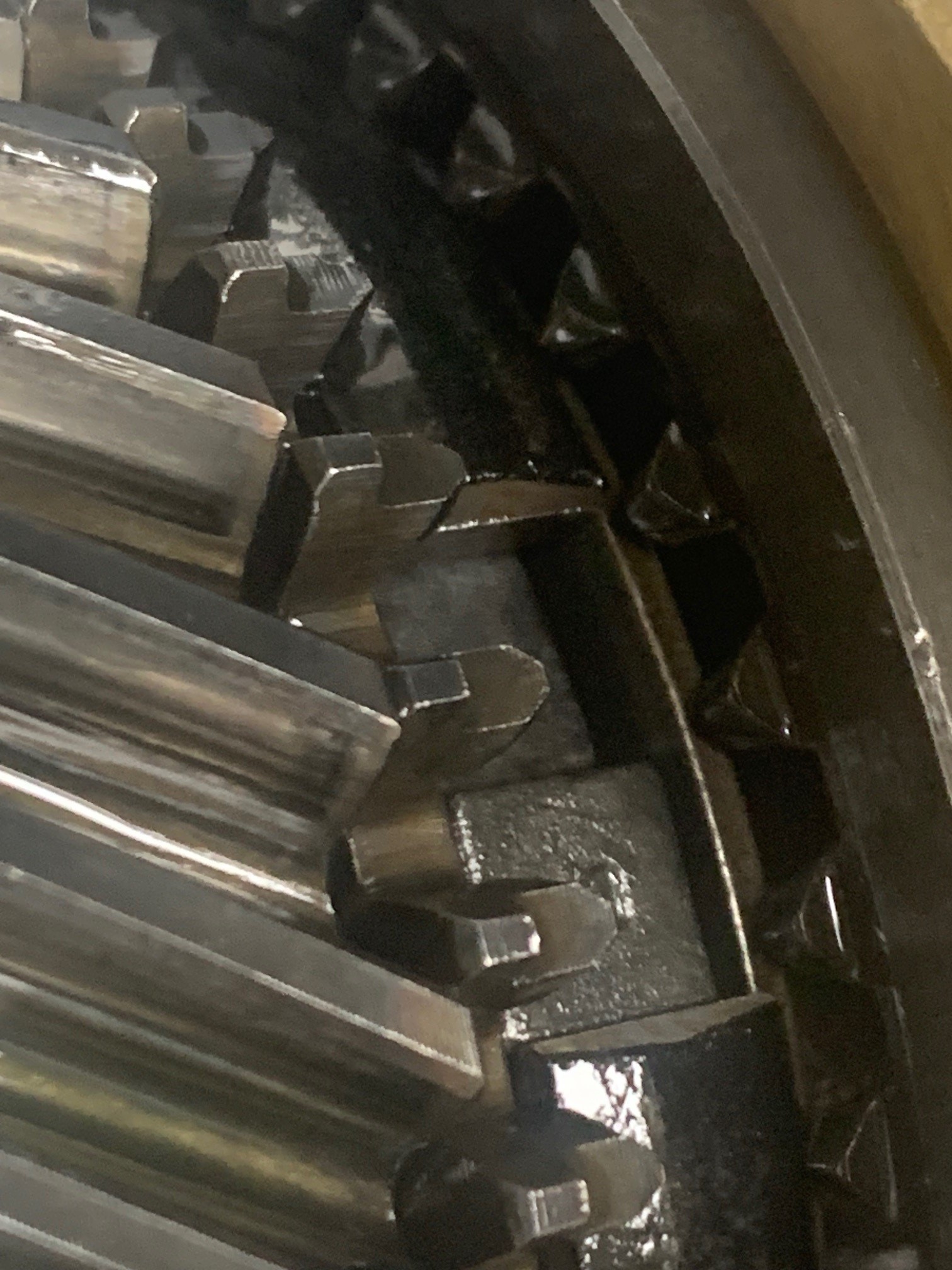

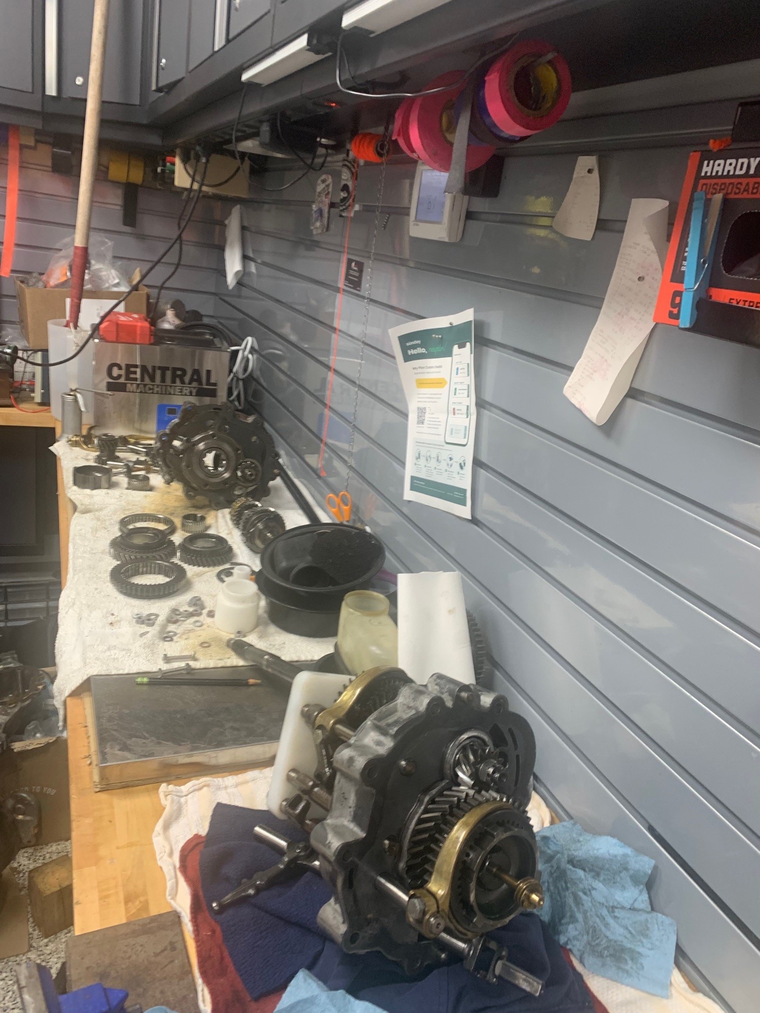

Two transmissions open, the core is as good as the one out of the 914-6,
Will be replacing Sync in 1&2 DogTeeth in 1&2 as well as the 1stgear/slider (money gear) for the 914-6 as to the core, will rebuild and have it as a spare
Should take care of the 1st to 2nd GRRRRRRRND sound......
