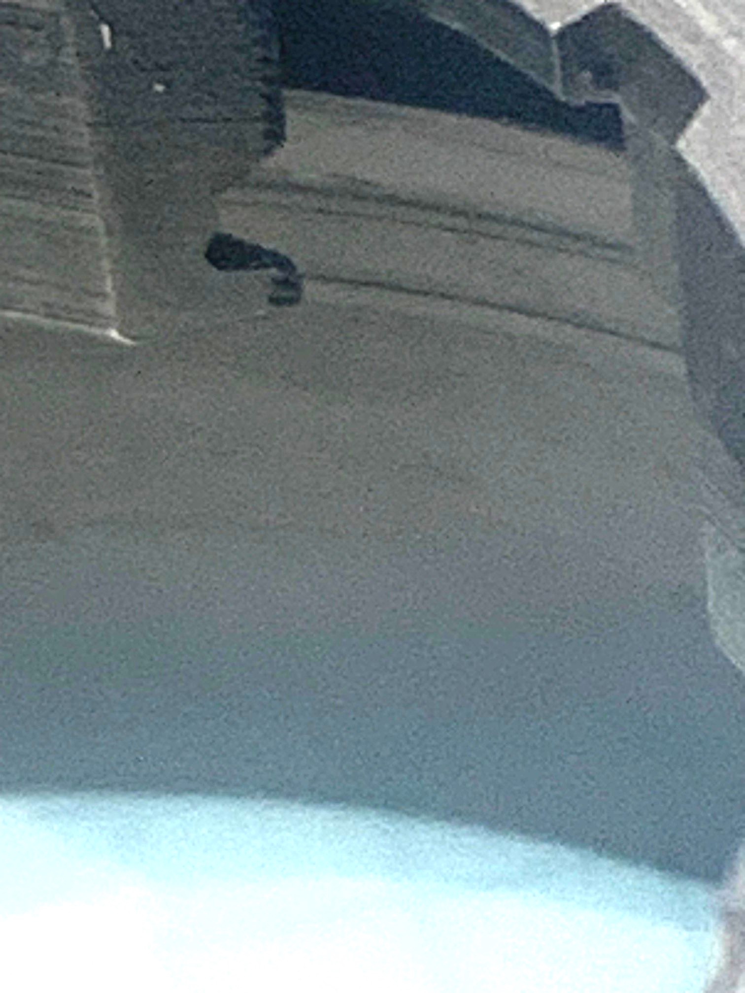

DOG TEETH Removal Stalled another week - perhaps 2. (IMG:style_emoticons/default/mad.gif)
Transmission Inspection this week - all looked OK, need 2 Sync Bands, 2 DogTeeth and a slider.
I found this - looking for the tooth in the case - it was not in the magnetic drain plug, not even in tiny pieces.
My home brew Dog Teeth removal tool (Muffler Clamps) did not work so I bought a P225 from a very reputable vendor - actually the only vendor that had one in stock - I believe I received a P226, it does not fit and is designed for a heftier gear. (IMG:style_emoticons/default/mad.gif)
The gear sits too high, the notch does not mate to the ring in the tool
Bad close up of the same picture - the two do not mate.
