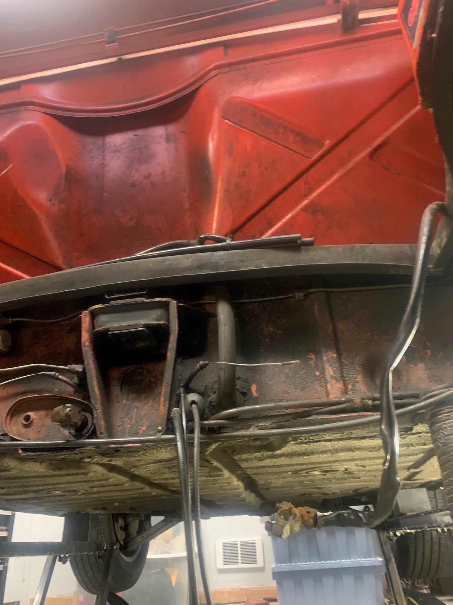

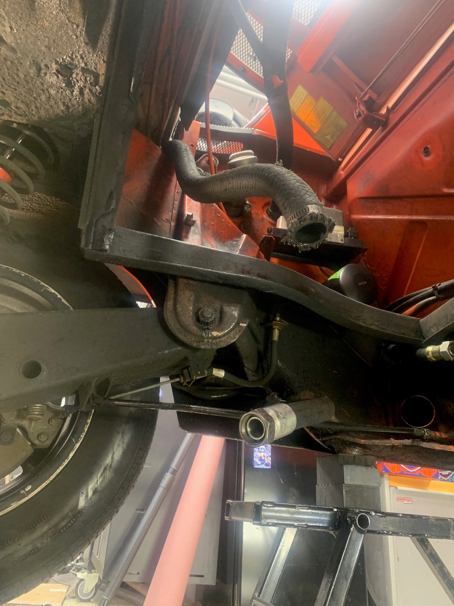

I am in the midst of removing the engine and transmission. All original. There is oil everywhere, not flowing but seeping - seems that the valve covers are not tightened or have loosened with age. Here are the first pics:
On the rack - hopefully not for long:
Shift Assembly is very clean, no wear, bushings are in good shape but all of them will be replaced
Heat exchangers have no holes in the pipes that I could find, the surrounding tin has been treated with anti-rust leakage - perhaps this was the plan in Stuttgart?
No plans to change the exhaust system - any guidance as to cleaning or preservation?

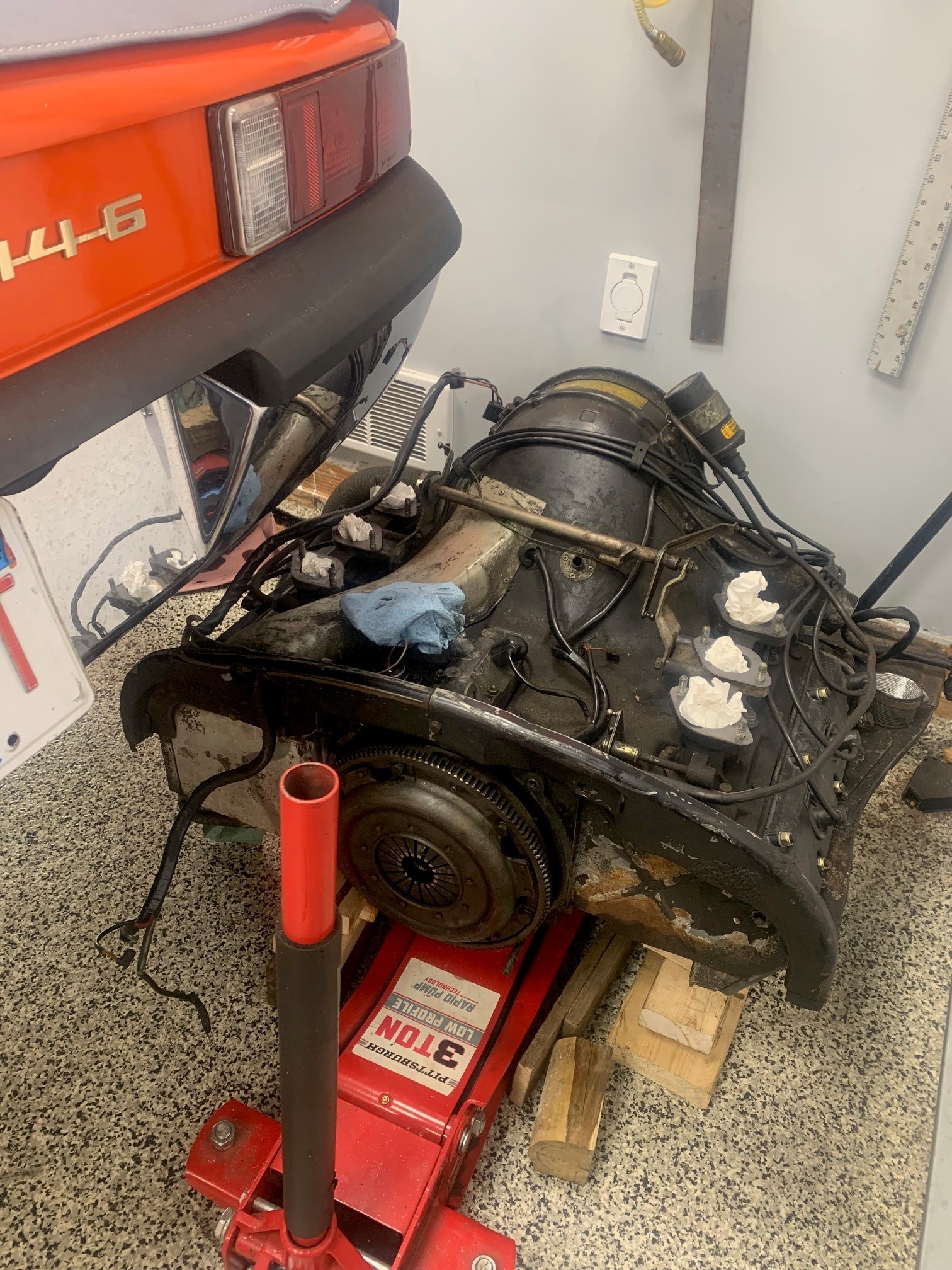

Afternoon Update
Got the carbs off which allowed me to remove the engine from the underside of the car.
The Engine bay is full of oil residue, next on the list is a good scrub! (IMG:style_emoticons/default/biggrin.gif)
Lots of work to do here - needs new fuel lines, have the stainless ready to go, (IMG:style_emoticons/default/smash.gif)

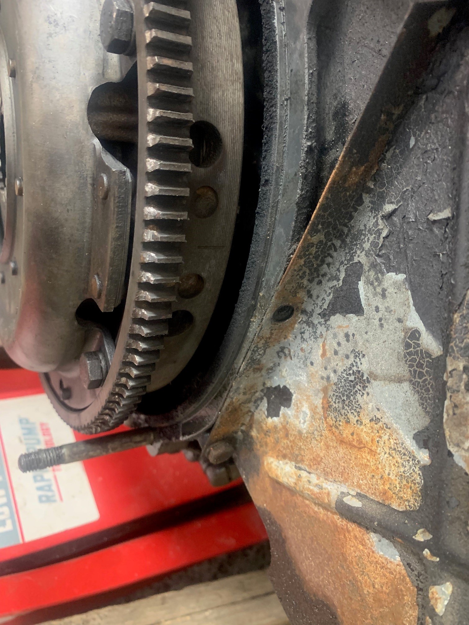

Fly wheel is ground up (IMG:style_emoticons/default/sawzall-smiley.gif)

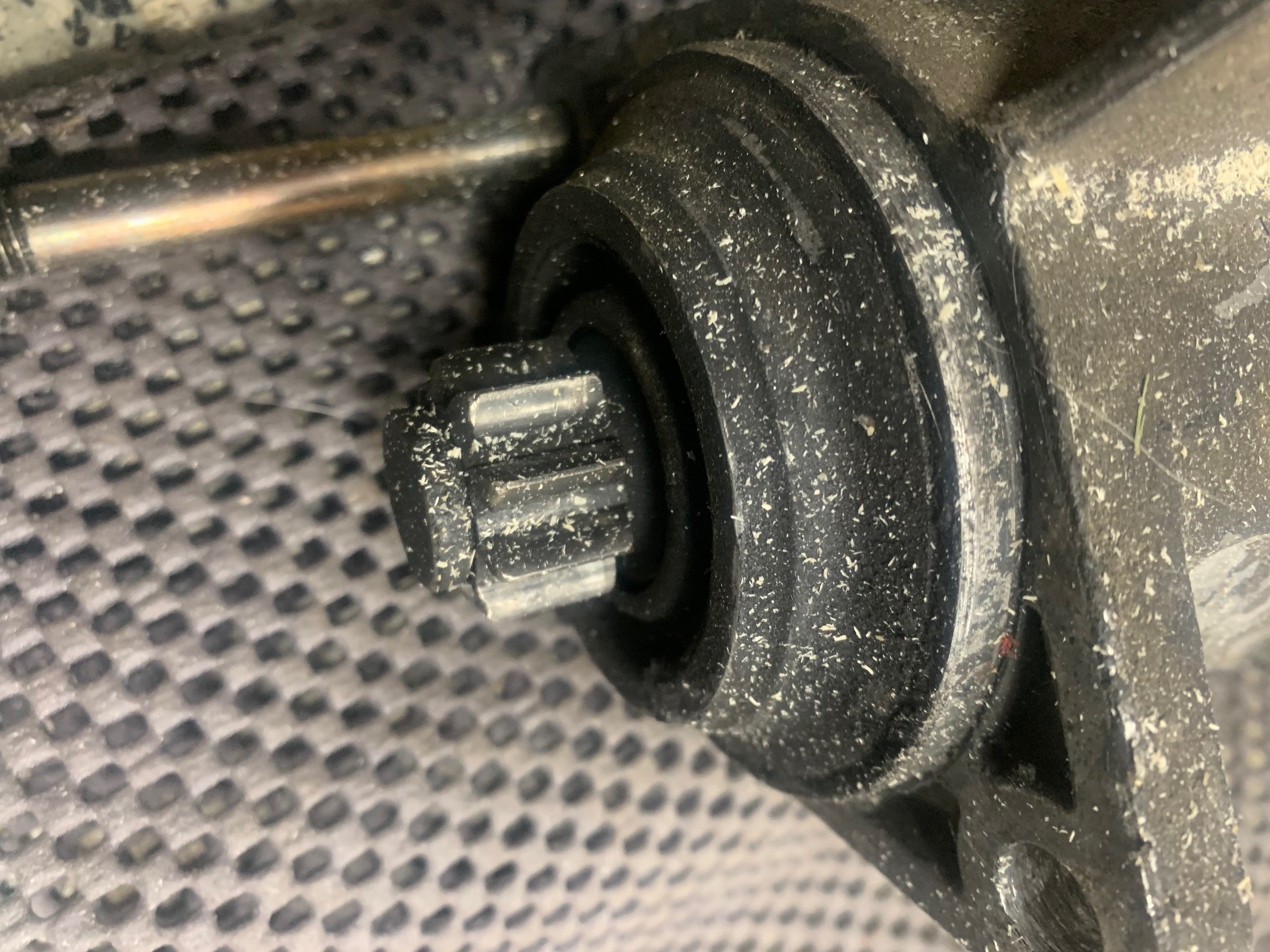

Starter gear is like new - perhaps it is a newer starter..... (IMG:style_emoticons/default/smile.gif)
