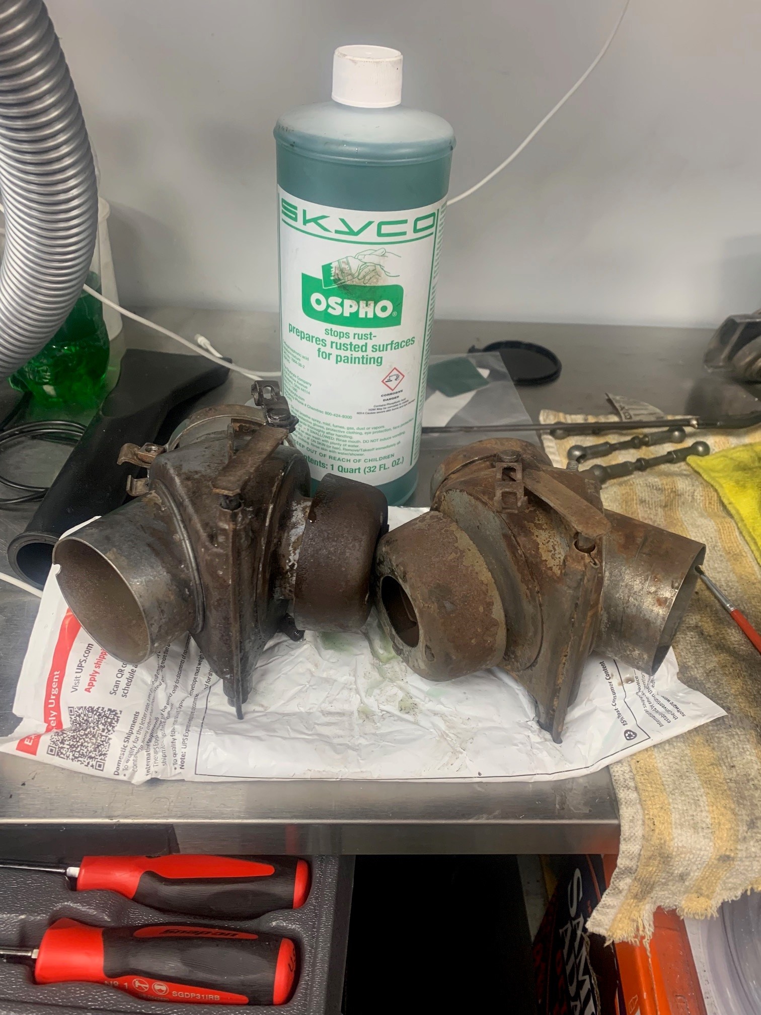

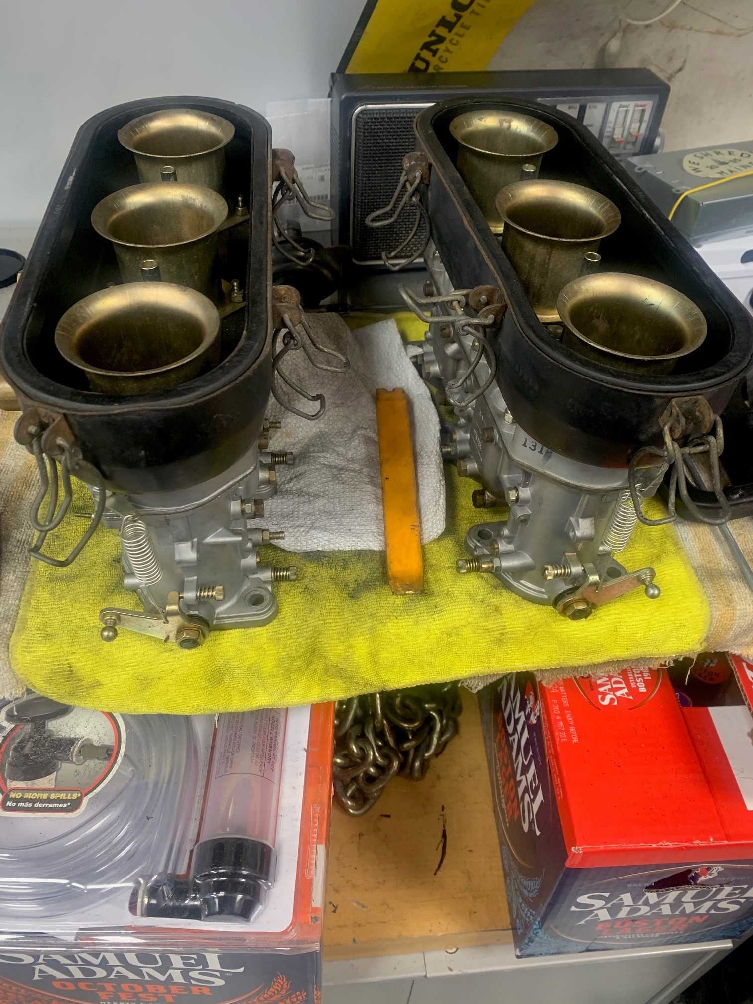

**********Afternoon Work Continued***********
Got the Carbs off - they look great
Cleaning the "Flap Control Boxes" used a solution recommended within these pages, Nice Before and After!
May powder coat once cleaned............

QUOTE(ctc911ctc @ Feb 23 2025, 02:52 PM) *
Your flappers look pretty good. Something that might be worth checking is the inside. The springs and the sealing surface. It wasn't obvious, but the springs on ours were broken. There is a thin one that keeps the disc aligned. This kept the flapper from smoothly going through its motion because the disc inside would bind. The disc itself seems to be fiber (maybe asbestos?) over mesh and can disintegrate.
