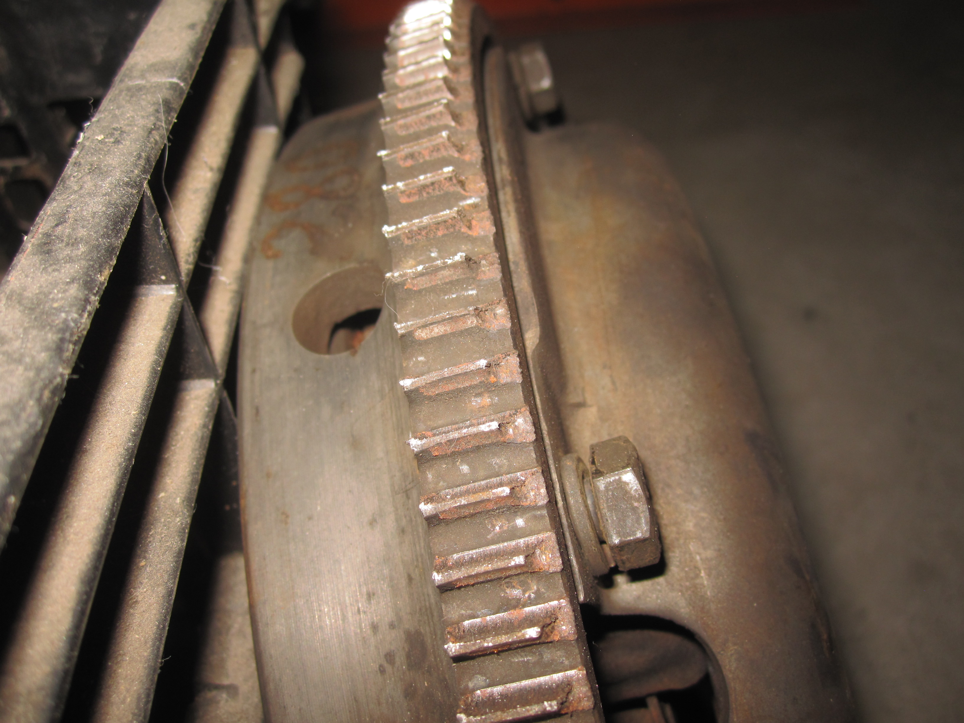

Is starter one of the gear reduction / Denso types? Some of those have been known to chew up ring gears like that.
So sad to see that type of crap.

I do not think so - I do not see anything other than direct drive, will check more thoroughly tomorrow - good night SH! Thank you for your support!

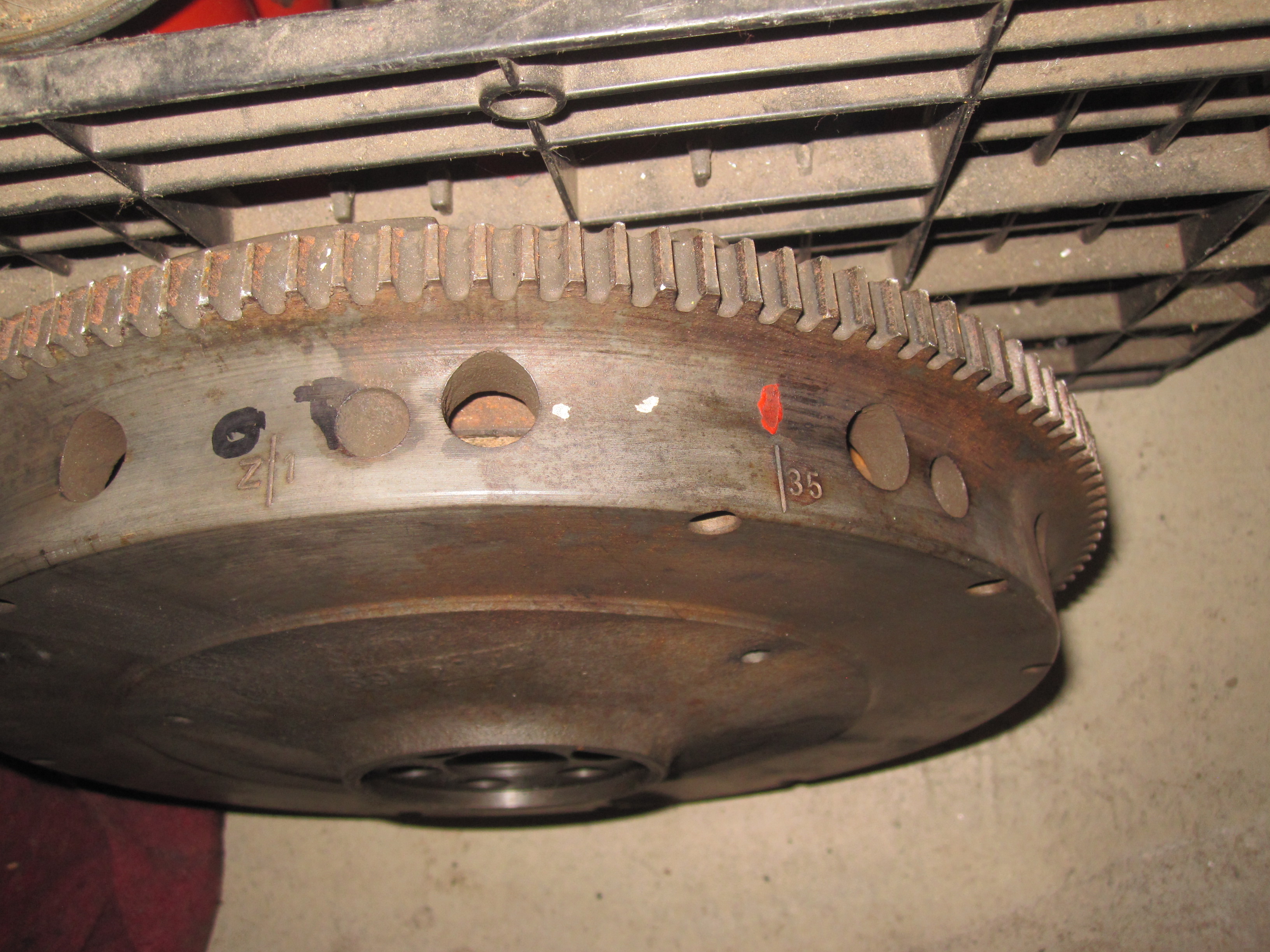

Cary your starter is standard 2.0 911- 914 6
Ring gear wear is common on these flywheels ... they've all endured 50 + years of use.
Consider it a consumable. Much like a pressure plate or clutch disc.
The 6 flywheel is the same as any 2.0 911 except...an original 6 flywheel is marked for
ignition timing and valve adjustment positions.
If you can't get a 6 flywheel (NLA) mark the one you get using the V belt pulley as the reference.
