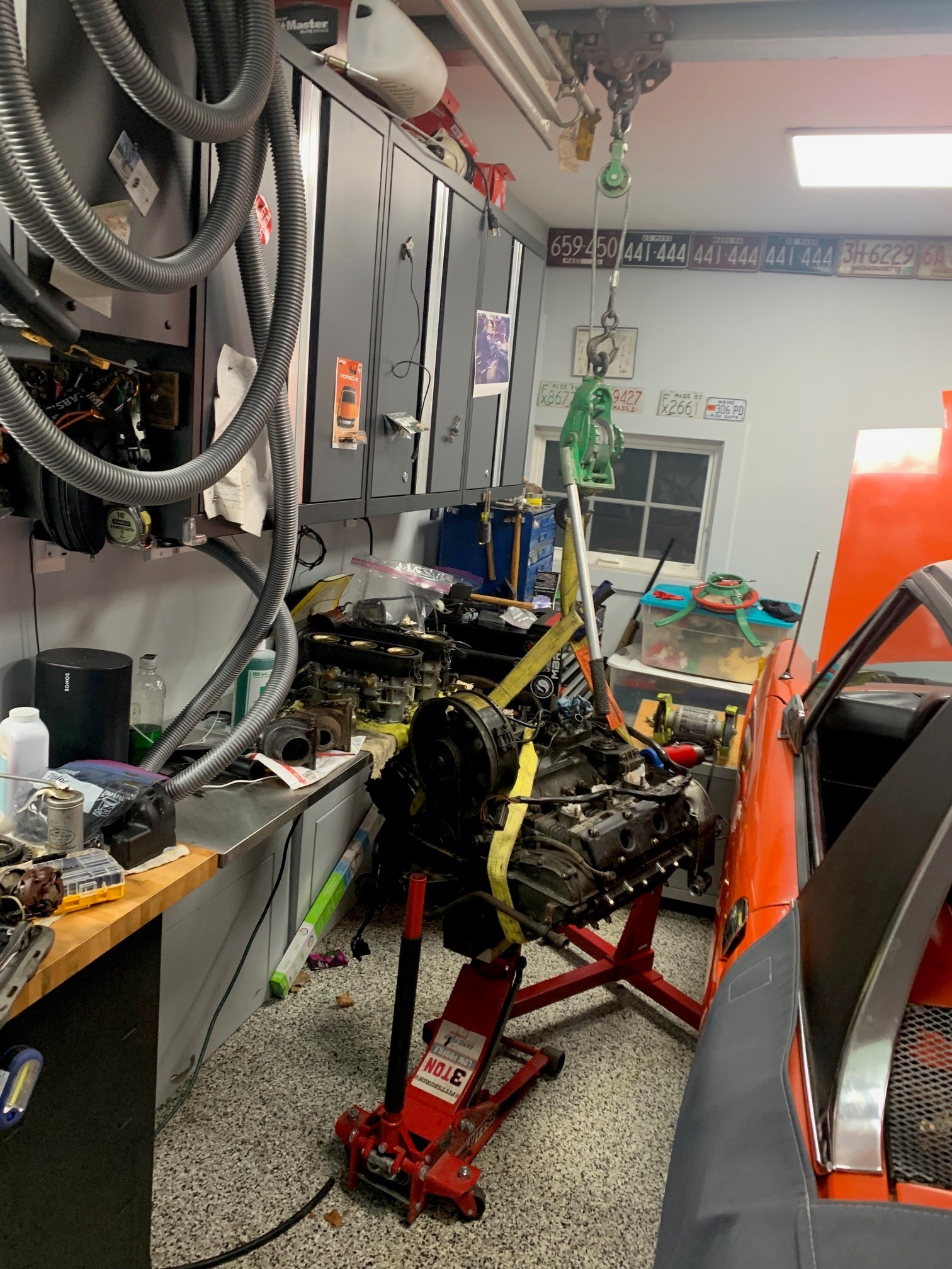

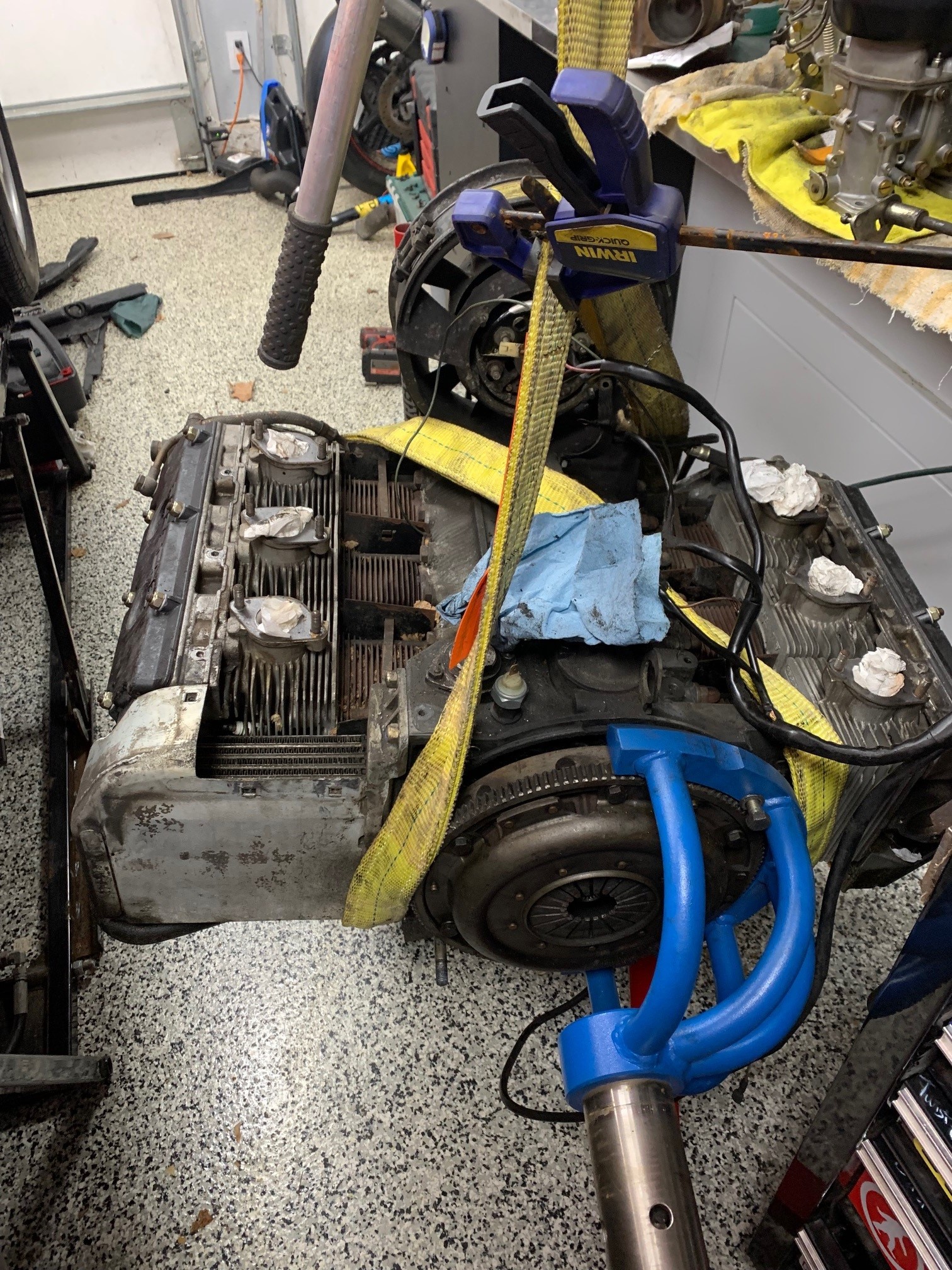

Spent a few hours this morning traveling to get a new flywheel from a fellow 914-6 owner - Thank you Mr. M!
Dragged the engine to the beam - when I rebuilt the garage I put in a beam, however, it is never where I need it so I had to squeeze the engine to the beam
Took off the tin and started washing it - perhaps 50 year of grime on the inside - in places nearly 1 inch thick. Scraped and then Dawn and a brush - will fine-tune the cleaning later
Tetris with the floor jack to get the engine high enough, the bean is rated for 4000, the pulley system around 2000 (so it says) and the engine is 400ish, still scary work, got the bolts to line up after realizing I was doing it wrong
